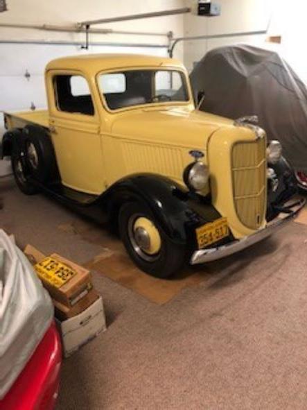

I am new to the forum and this is my first message have patients with me. I have a 1936 Ford pickup I recently purchased and I have been cleaning out all the systems as I believe the truck has set idle for most of it's life the last 25 years. I siphoned all the gas out of tank then flushed the lines removed the carb disassembled and cleaned all the parts reassembled it and it starts and runs fine. I flushed the radiator blew it out as best I could with an air compressor filled it with distilled water & radiator cleaner drove it around and then drained it and put in 50/50 Prestone antifreeze. That all seems OK. I drained the oil out of the transmission and put in new 90 weight gear oil per the manual. Now my problem is the transmission. While I was doing all the above service work I was driving it around and the trans seemed fine. The last couple times I have driven it when I let up on the gas in high gear or sometimes just driving with no throttle or very light throttle the gear shift lever will start bouncing and it sounds like it is trying to go in or out of gear and rattles very loudly, if I push in the clutch and shift to neutral and reengage high gear it goes away but sometimes returns. What do you guys think is happening?
