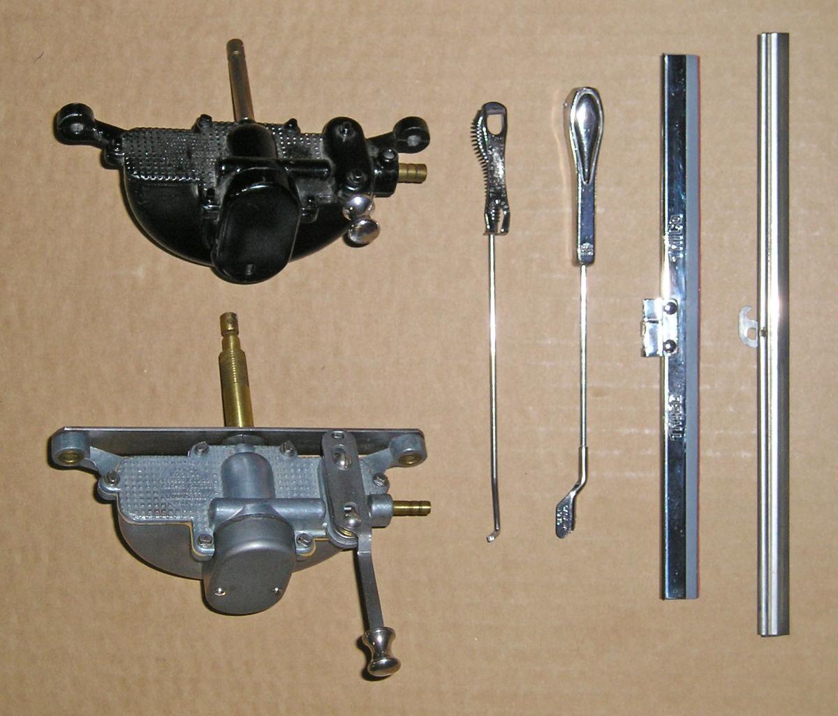

  Doesn't sound right for a '34. (A photo would be a big help to see what you have.) The original wiper motor shaft had a recess in it near the outer end right behind a small hole through the shaft close to the end of the shaft. (You can see the recess and the small hole in he shaft of the lower wiper motor in the photo.) Your wiper arm, if original, should look like the one in the photo closest to the two different wiper blades. The cover on the top of the arm has a spring beneath it like the spring in the arm next to it and a half-round swiveling piece that seats in the recess in the wiper motor shaft. The top end of the arm has a 90 degree bend in it at the very which fits in the hole in the end of the wiper motor shaft. To remove the arm from the shaft, slide the cover upward to free the swiveling piece from the shaft recess and then pull the end of the arm out of the hole in the end of the wiper shaft. Reverse the procedure tore-install the arm on the wiper motor shaft.
The configuration of the wiper motors varies by body type so your wiper motor may look slightly different than the two in the photo. It is how the arm fits on the shaft that is common among all the motors in a given model year (through the 1936 model year).

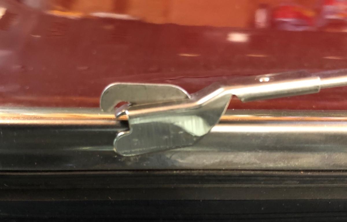

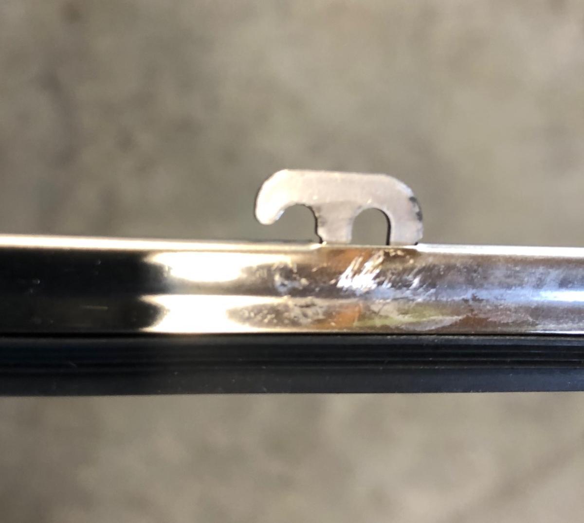

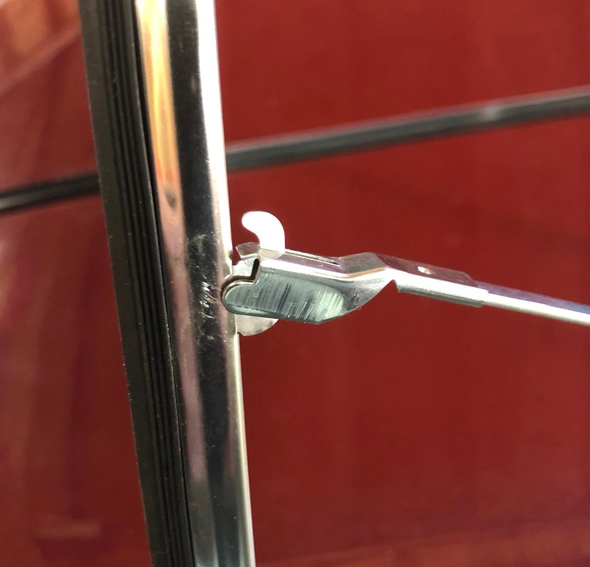

51woodie    -- 08-22-2022 @ 10:26 AM
  Not sure if the 34 wiper is the same as the ones on my '46 Coupe, but here are some pics of what they look like. Mine go on as 40 Coupe described.
