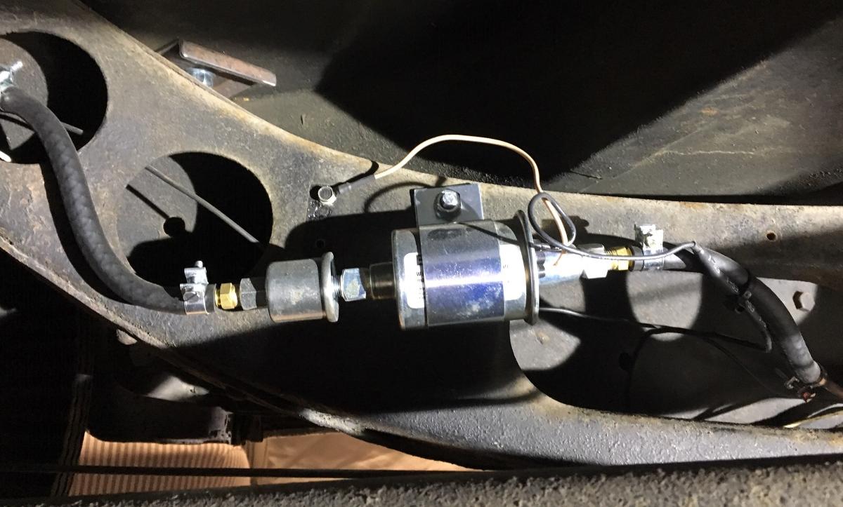

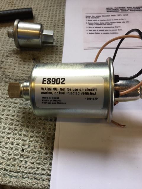

51woodie | -- 08-13-2022 @ 7:31 AM |
I have the Airtex E8902 on my stock'46 Coupe, that I only use for "priming" after the car has sat for a long time. It is activated by a toggle switch under the lower edge of the dash, and I shut it off when I hear the sound of the pump start to change, meaning the carb is full. If you can't find this unit, make sure the one you buy is a "flow through" design, if you are running a stock fuel pump. Check the picture of the mounted pump for wiring connections, if you still have a + ground system. Here are the specs. https://airtexasc.com/product-details?partkey=000759645
