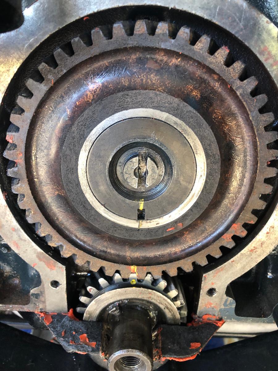

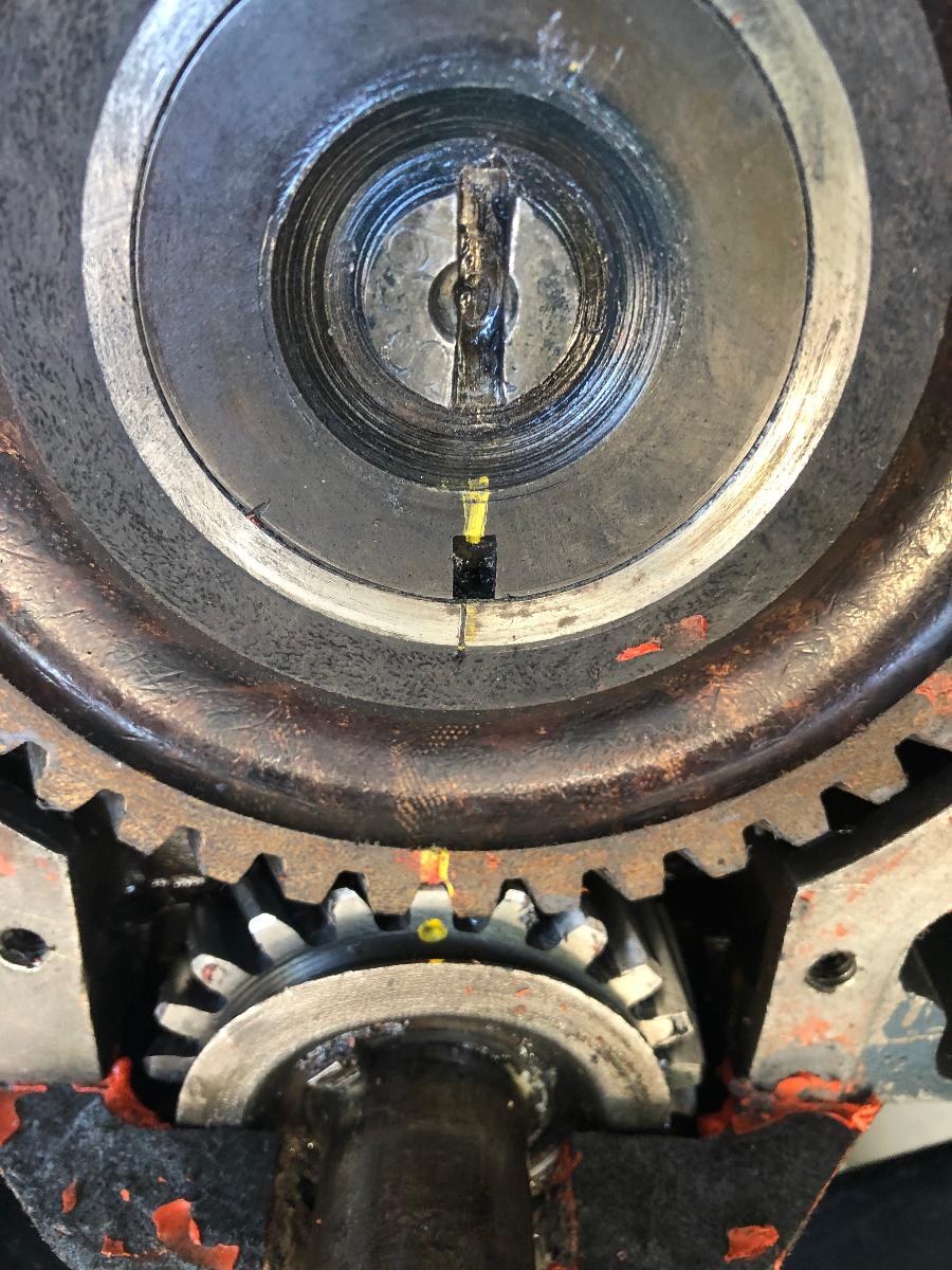

gmcbuffalo | -- 07-23-2022 @ 12:22 PM |
Here is what I found. Greg Meiling 1935 3 Window Coupe
gmcbuffalo | -- 07-23-2022 @ 12:30 PM |
I notice a tiny notch at the 7 o’clock position. Should the line in the cam gear have been lined up with that and not what I have? Greg Meiling 1935 3 Window Coupe

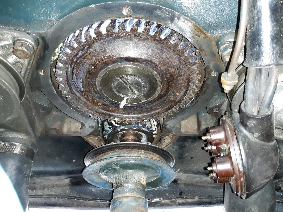

gmcbuffalo | -- 07-23-2022 @ 12:52 PM |
Based on this photo from an thread about removing the gear with the engine still in the car I think I have the gear miss aligned. Should have used the tiny tick mark. Am I right in my thinking? Greg Meiling 1935 3 Window Coupe
carcrazy | -- 07-23-2022 @ 1:48 PM |
You are correct. That tiny mark on the end of the camshaft is the timing mark. That mark must be lined up with the timing mark (line) on the camshaft gear to insure the valve timing is correct.

37RAGTOPMAN | -- 07-24-2022 @ 12:23 PM |
remove number 1 spark plug, turn the motor over till it hits top dead center, on compression stroke, use a long stiff wire to get the feel, welding rod, 1/16 both valve closed, then, you can see this though the hole with a good light, check were your timing marks are at if off, I would remove the fiber timing gear and check to see if it spun on the metal center, it would have been nice to have the bolt on timing gear, but pressed on can be changed in the car, but not that easy, but it is possible, hope this helps 37Ragtopman
