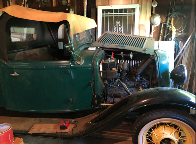

  My Uncle has a 1933 Roadster Pickup. I am trying to validate the serial number on the title and I am having trouble finding what numbers were used on the open cabs. If anyone has this information I would greatly appreciate it.

  The Title must be incorrect as it reads DRF-100xxx. Does this prefix mean anything to anyone? Maybe a Model A title was used to register this truck? This truck is most definitately a 1933 or 1934 Open Cab truck. I will look for a number on the frame. Thank You.

  Tomorrow I will look for the number on the transmission/bell housing and the frame rail. The engine was replaced with a 49 Merc. and it has been repainted. It has been in PA for the last 50 years, I don't know its history before 1970. It has been repainted, but I will still check the door jamb. Thanks everyone, I will report back what I find.

  At one time someone was reproducing '33/'34 roadster pick up bodies. Can you provide any pictures?

NitroRods    -- 07-09-2022 @ 6:40 AM
  looks like I don't have the original transmission. Not sure what year it would be, 36 or 37?
Model B    -- 07-09-2022 @ 6:59 AM
  Appears to be a 1936 transmission.
