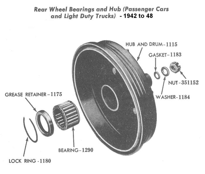

  Unless there is a problem with the rear axle, it does not need to be removed and disassembled. That requires experience beyond the usual old car owner. The rear wheel bearings are serviced by removing the hubs using a puller designed for the task. Don't forget to back off the brake shoes to allow the hub assembly to be removed after removing the cotter key that secures the nut holding the hub to the axle. With the inside of the hub facing upward, locate and remove the large snap ring
that holds
the seal in place. Pry the seal out, and remove the bearing. Clear out any remaining grease inside the hub and pack it with new grease. Use only the grease designed for the task. It is available at most parts places, and should be labeled as
"heavy duty wheel bearing grease". Pack the bearing until it is filled with the grease. Place a new seal over the hub and bearing gently and tap it into place with the lip of the seal facing the inside of the hub. We use a plastic pipe coupling from a "home center"that fits over the seal and allows driving it until it is past the snap ring groove. Insert the ring, and be sure it is in the groove all the way around. Lube the seal surface with a bit of the bearing grease. Turn the hub up and remove any remnants
of the old seal, which looks like a washer. Place it over the end of the axle and secure it in place with the large nut and washer. Tighten the nut securely. We mark the end of the axle to show the position of the cotter hole. Tighten the big nut until it can't be turned further. This seats the hub on the taper of the axle. Turn the nut only far enough back to allow the
cotter pin to be full inserted (that is why we mark the end of the axle) and be secured.

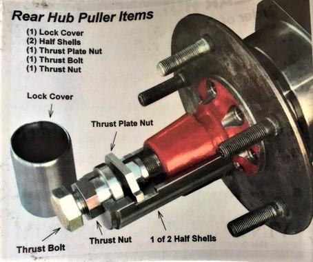

The wheel hub puller from Vintage Precision Inc. is excellent.
http://vintageprecision.com/products/hub_pullers/index.html
The torque on the axle nut is 200 ft/lbs. It is important that the axle shaft taper and the inside of the hub are clean of any lube.
