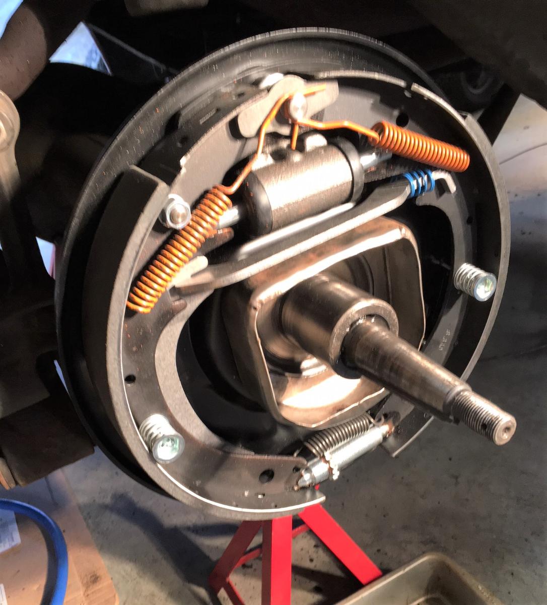

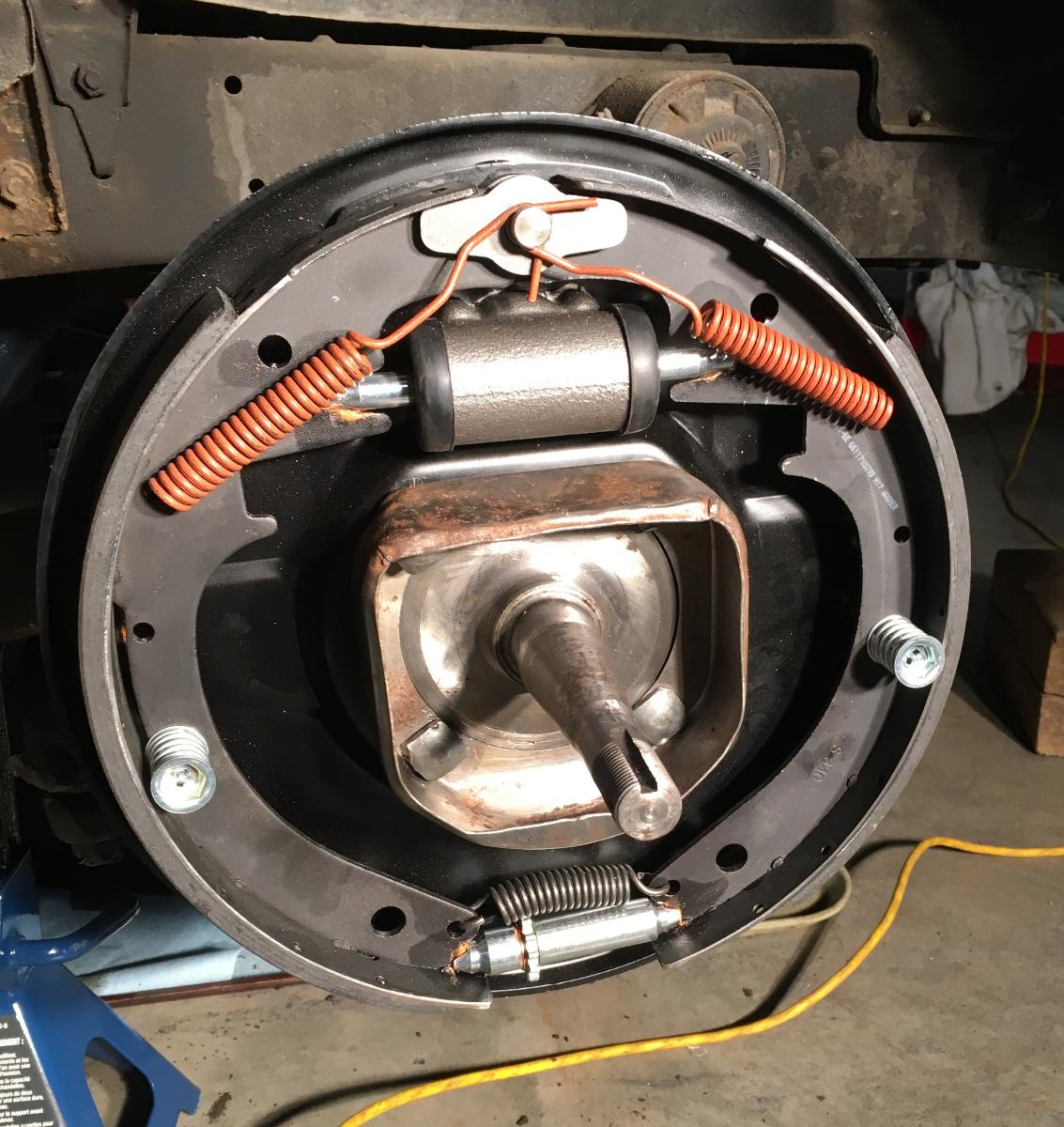

Gary, I think you are going to be hard pressed to purchase a 'kit' to convert your mechanical brakes to hydraulic, while retaining the stock 36-39 wheels. Most conversion brake kits available from the after-market vendors will be for conversions to later model 5 0n 5.5 bolt pattern wheels with later model hub caps. My suggestion would be to hunt down a set of '42-48 backing plates, they are quite common and are better brakes than the '39-41. You will need a set, front/rear '38-39 drums. The '38-39 drums are quite hard to find, you might have to have a set of drums rebuilt, there are a couple of company's that do this. You will also need '40-41 front spindles and a '39 Ford peddle assembly. You will need a hand operated parking brake assemble which can be constructed using '40-41 parking brake cables that operate via a modification to the 36 parking brake handle assembly on the rear of the trans. There are people that will tell you that there are conversions available to modify the '36 spindles to accept the later drums, for my money the conversion to '40-41 spindles is a clean straight forward simple solutions. Bill 36 5 win delx cpe

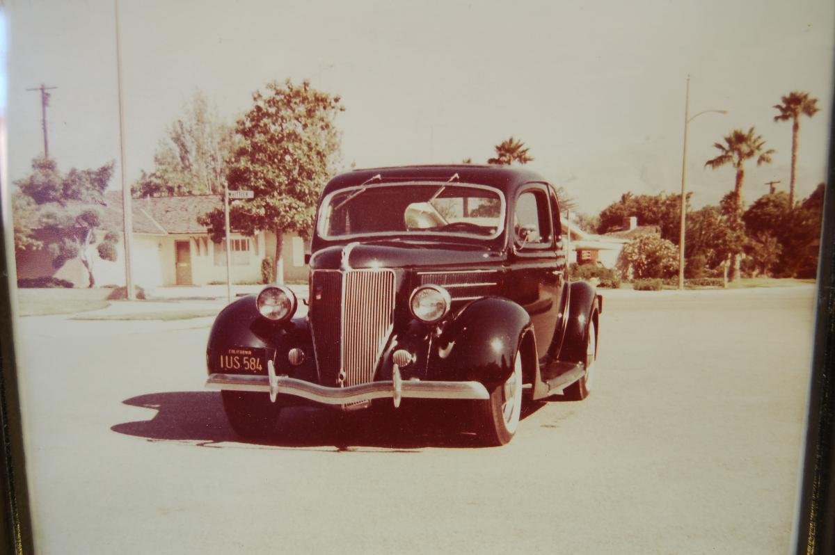

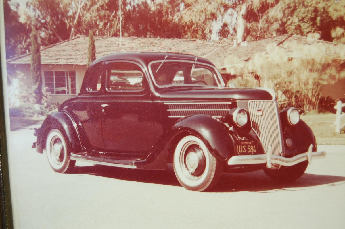

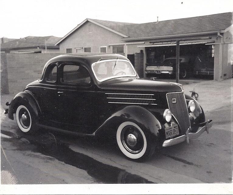

When I converted the brakes on my '36 coupe from mechanical to hydraulic in 1952 I harvested parts from a '40 and '41 Fords. Used '40 steering gears, '39-41 brakes with 5-5.5 lug wheels. I jury-rigged the '41 master cylinder, which for quite awhile worked well. Used many styles of aftermarket hub caps that were constantly being stolen, finally went to '46 Ford caps which lasted for almost ten years. Over time I came to dislike the early brakes, very difficult to keep in adjustment with the lower and midway adjustment. The clabbered together master cylinder also became a problem in heavy traffic stopping. Moved from Idaho/Nevada in '56 to Los Angeles. Doing some investigation I found that a '39 peddle assembly would bolt right into the '36 chassis with very little modifications. Since I had already converted the front axle to '40-41 spindles the 38-39 drums would work perfectly with '42-48 backing plates. The wide five 36-39 wheels and '36 caps fit like Henry meant them to be on the car. I have converted several '36-38 Fords to the components I have suggested with no problems. The one problem in this day and age is the '37-39 drums.. Drake has the peddle assembly, the '42 -48 backing plates, etc., should be pretty easy to obtain. If you are going to do the brakes i would strongly suggest that you convert the steering gears to '37-40... A bolt in application that is almost like adding power-steering compared to the '36 worm-sector steering. Bill 36 5 win delx cpe
