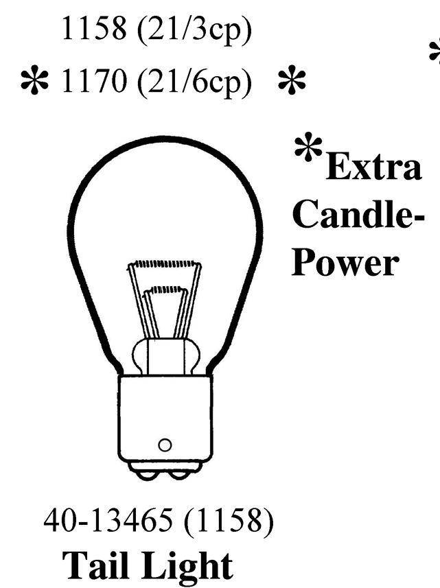

Don Rogers | -- 04-14-2022 @ 12:41 PM |
As 40 Coupe has stated the correct tail light bulb is 1158 and the pins are perpendicular to the contacts. Here is an image showing the 1158 as well as the higher candle power 1170.
