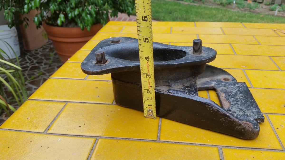

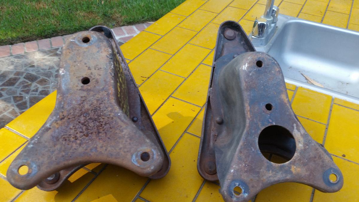

I have removed several '35-36 spare tire mounts from unmolested vehicles. The '35 mounts are generally cast iron whereas the '36 mounts are generally stamped steel. i have never encountered anything that appeared to be an insulator/gasket between the mount and the body. Reviewing a couple tire mounts I have in stock, there was shinny black paint in a circular pattern around the body side of the mount, which would indicate that the mount was in close contact with the body. My suggestion would be to purchase a 3/4" round rubber disk/gasket, to serve as an insulator between the mount and the body. Note, the '35 tire mount has been modified, shortened, to move the tire closer to the body. Bill 36 5 win delx cpe

A foot note on the '35 tire mount shown in my earlier contribution. The cast iron mount was on my '36 coupe for many years so that the later model 5 on 5.5 wheels were on the car, and therefore a matching spare tire was required. I removed the '35 mount in 1961/62 when I switched the wheels to the 36 wide style 5 on 10.5. Bill 36 5 win delx cpe
