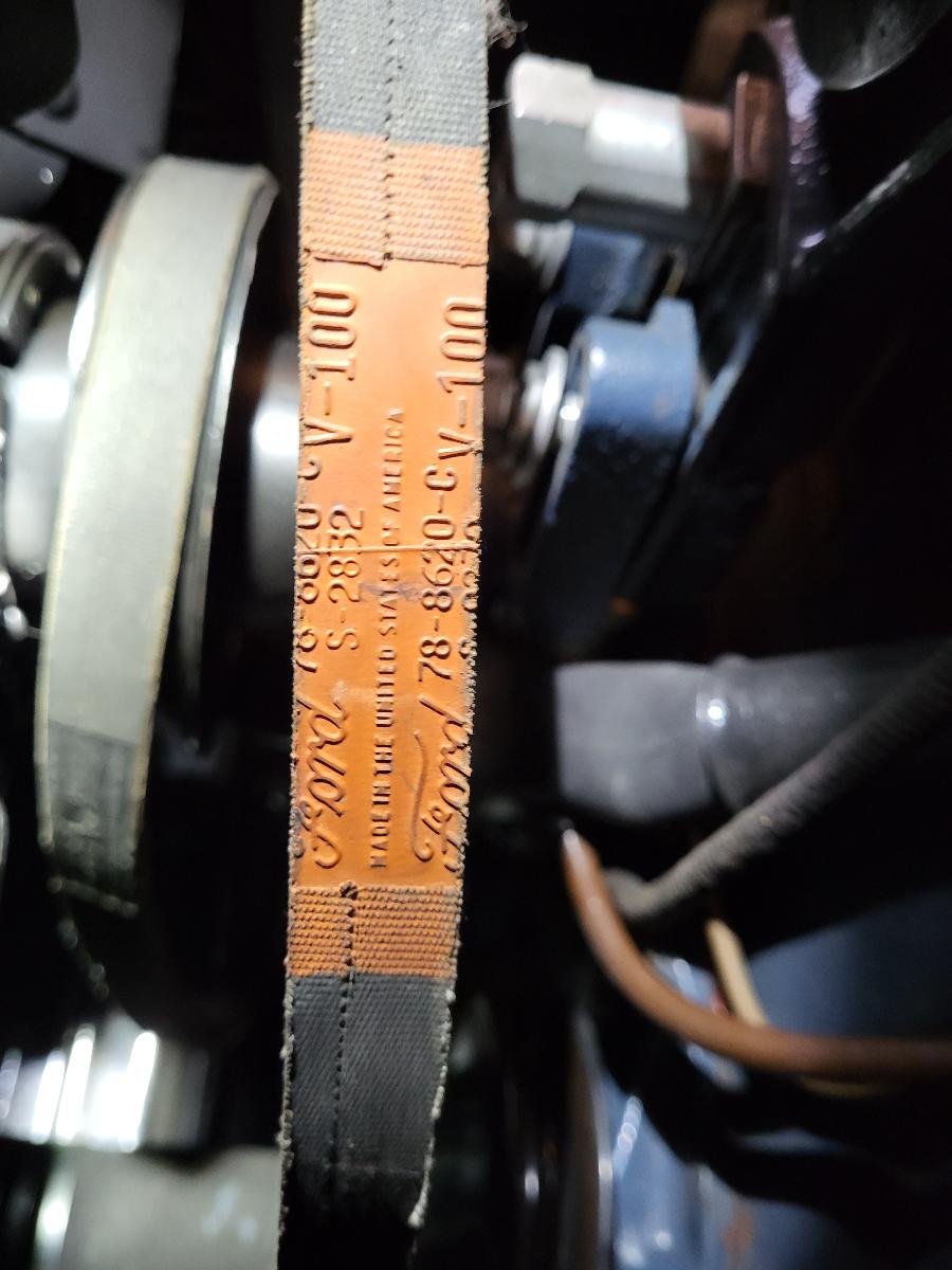

Thanks everyone for your insights. A picture of the NOS belt is attached, it looks to be a genuine Ford part to me. I've tried to remove the generator retaining nut and pulling the generator forward and tilting it as far as it will go but, I still can't get the belt on. Can you remove the stud that the generator sits on? Since I'm taking the car to the Western national meet this year to get a Dearborn award I want to get everything correct. Up to now I used a NAPA B52 belt which works fine but is not marked correctly. This message was edited by cknudsen7 on 3-5-22 @ 12:58 PM

Your pulley diameter should be 3.18. This is measured on the front of the pulley. If the belt has the correct inner diameter, you can try this to install the belt. Make sure that the belt is in the crank pulley, route it so that the right side water pump pulley and the generator have the belt in their pulleys and then try to install the belt on the left side water pump pulley by tipping the generator forward. If you cannot get the belt on, you can try using lacquer thinner or acetone to remove the markings on the NAPA belt. A Sharpie permanent marker will cover some markings without leaving a shiny surface. A belt with no markings should be acceptable to the judges. I haven't tried the latest reproduction from Drake with the raised script and P/N, but that might be another option. Let us know when we can congratulate you on your cars Dearborn Award. Tom

cknudsen7, If you have the correct diameter pulley (TomO had stated the diameter in his post) then there is no reason your belt should not go on. It is a pain in the butt to install but it does fit. The "A" suffix belt will fit much easier but is not concourse correct. The "C" suffix belt is concourse correct for your car. However, the red area is indicative of a service - replacement part. A good judge will know this and should make a deduction on the concourse. Mike "Kube" Kubarth
