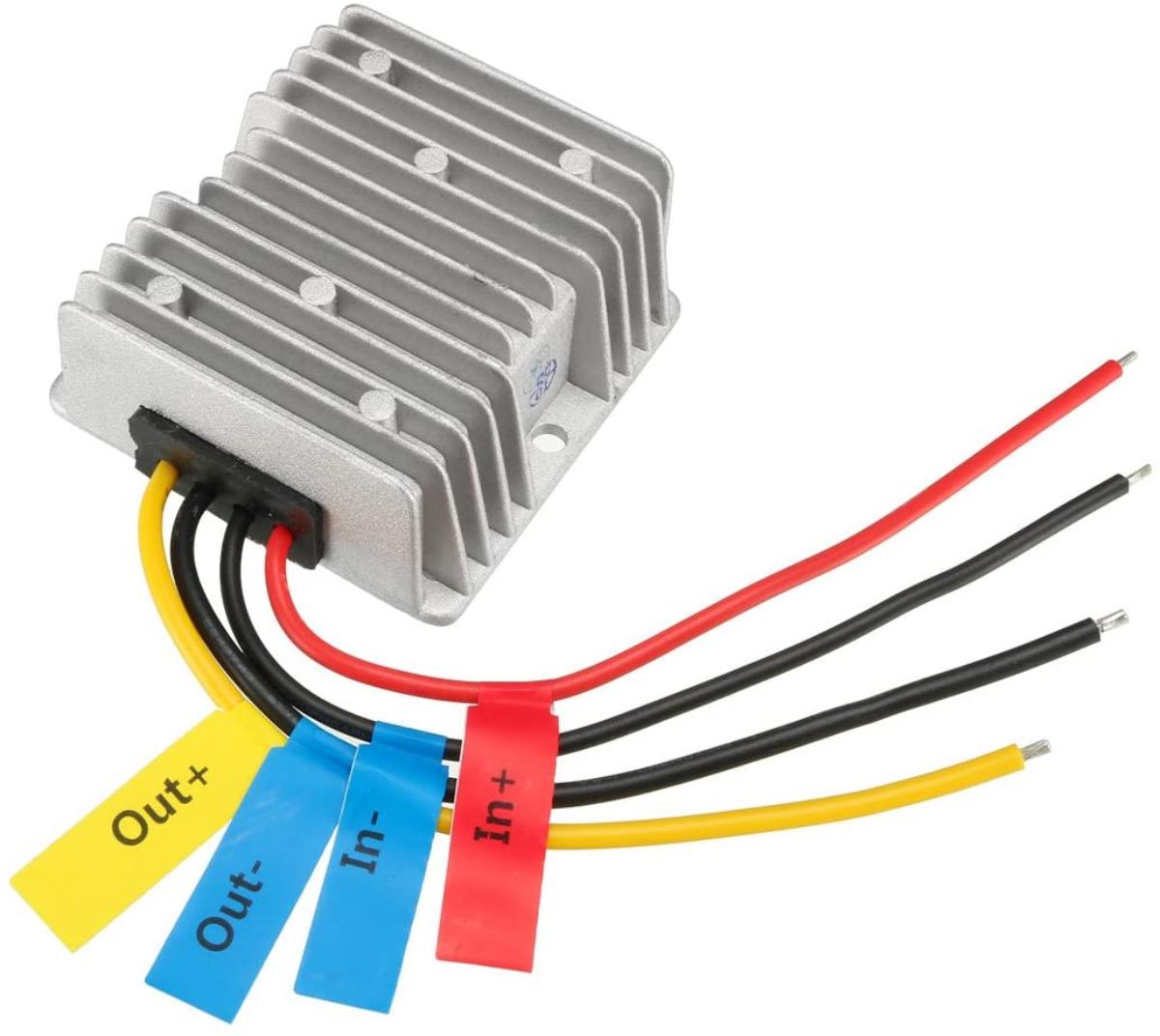

budlite28 | -- 02-19-2022 @ 1:04 PM |
what about something like this? uxcell Power Voltage Converter DC12V/24V to DC6V 20A 120W Waterproof Voltage Convert Transformer

juergen | -- 02-20-2022 @ 8:29 AM |
The uxcell convertor certainly has the right specs and needs no adjustment.
