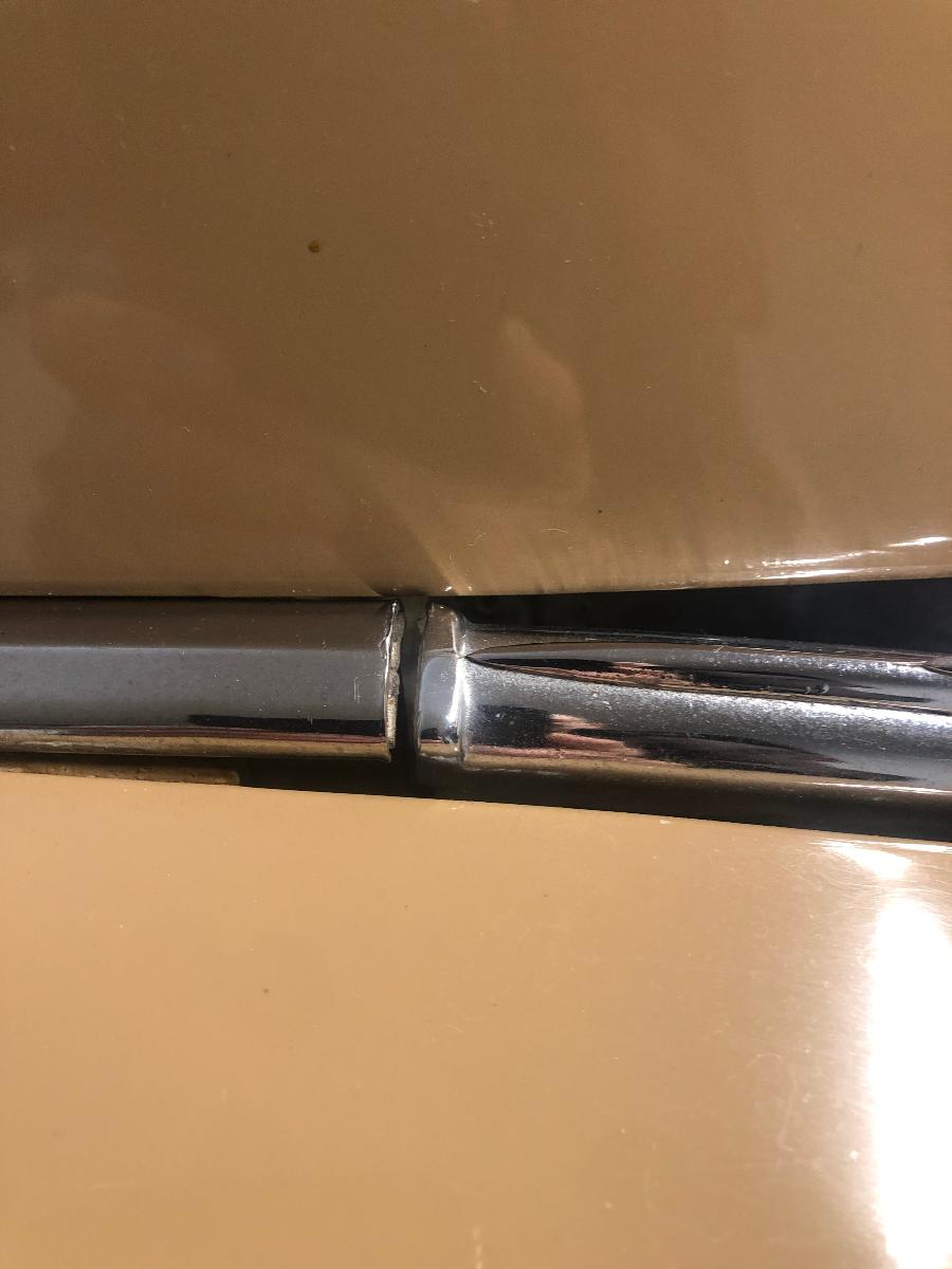

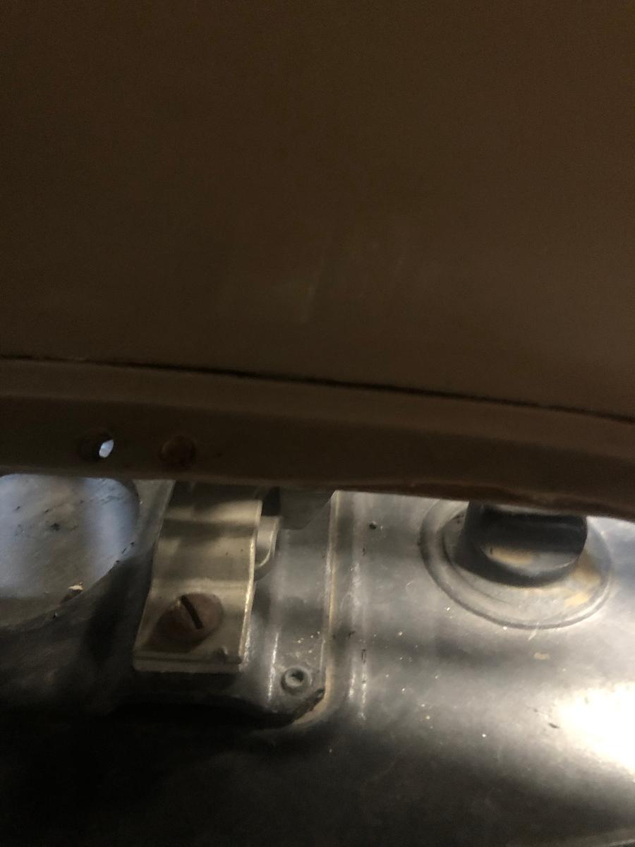

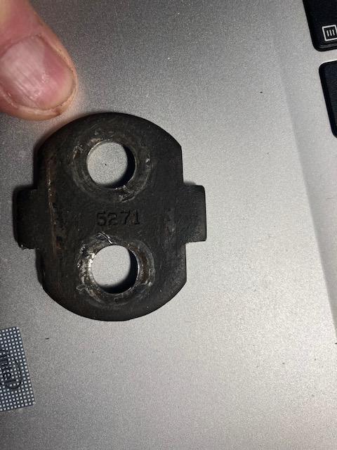

Can anyone show a picture of the correct mounting of the hood emblem and center hood strip mount on a 36 Ford 5 window coupe? I confirmed I have the correct emblem and stainless strip but there is about a one-inch gap between the two when mounted. The grille emblem doesn't sit flush on the radiator either. I'm thinking I need to adjust the radiator back, but I still don't know how the two pieces would mount in relation to each other. Also, can anyone identify the item in the second picture. It has 5271 stamped in it and I think it has something to do with the emblem or strip mounting but not sure. Thanks very much

The radiator needs to come back towards the firewall. Also it looks like the radiator emblem is broken. Two screws hold it to the radiator and it looks like one side of the emblem is broken off in the photo.

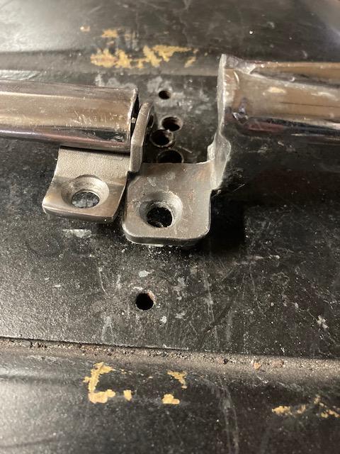

This is my Tudor,I would think they’d be the same. This is with the Greyhound. TIM CARLIG

Tim Carlig has posted good photos. Buchanan: you have missing parts and broken parts. Check your private message.
