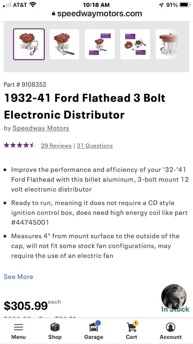

I hate the stock distributor, so challenging for me to connect plug wires. I prefer a crab distributor. I was thinking of going electronic. What’s the general consensus? Thanks, Tim TIM CARLIG
TomO | -- 01-27-2022 @ 8:34 AM |
Save you money. The 1936 distributor is much more reliable than the electronic conversions. Points will give you lots of warning before they fail, electronics may not. You will only have to change the wires every 50,000 miles and the inner caps every 25,000 miles. The points should be changed every 15,000 miles. You probably wont put on more than 3,000 miles a year living in the Chicago area. You need to change all of the plug wires, coil and timing gear cover in addition to the buying the conversion distributor. Tom

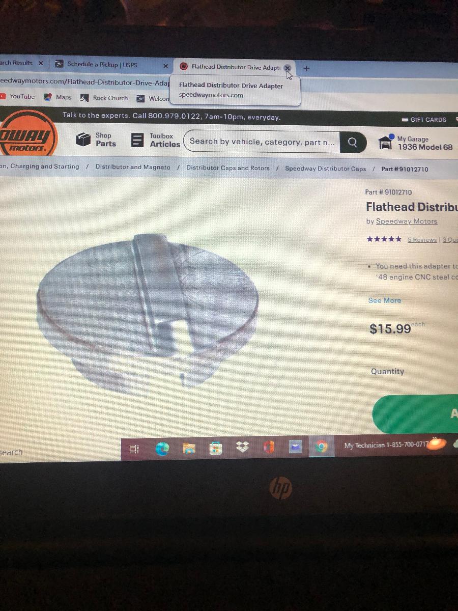

I’ve decided to install a crab distributor. In addition to the 2-3 hole adapter, will I also need something to fill the gap between the tang on the distributor and the slot in the timing cover after the adapter is installed? Thanks. TIM CARLIG This message was edited by dean333 on 1-30-22 @ 5:18 PM

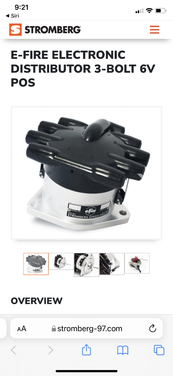

Hi Tim You should consider the Stromberg “e-fire” distributor. Crab style, all new. Available in two or three bolt configurations, 6 or 12 volt and positive or negative ground. Made in England, by the same people reproducing the carburetors. This message was edited by 1938cr on 1-30-22 @ 9:37 AM
TomO | -- 01-30-2022 @ 1:50 PM |
Wow, $430.00 +shipping, like I said before "save your money." Tom

I made a deal with Skip Haney. Gonna take my distributor in exchange for a crab plus a coil for $175. Still haven’t got an answer as to if I’ll need something to fill the gap between the adapter and the timing cover slot. I’m thinking the tang on the distributor won’t reach the slot after the adapter is installed. TIM CARLIG This message was edited by dean333 on 1-30-22 @ 5:19 PM
