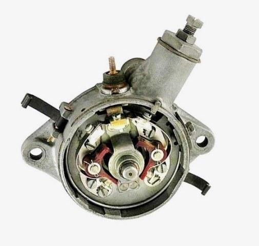

Come on now; WAKE UP! If the ignition switch is on and the points happen to be closed; it will drain the battery. If you're lucky and the points are open; no drain on the battery! Remedy- "Always turn the ignition switch OFF!!" Regards, Steve Lee

Tmusk. It looks by your post, you are new to old flatheads, and Steve's post is a little terse. So welcome to early Fords. I had a lot to learn when I got my '46 Super Deluxe Coupe a few years ago, and one of the lessons was, to never leave the ignition switch on if the engine is not running. Steve is right about the points closed with the engine not running makes a complete circuit. If the point/s (a stock distributer has two sets) are closed, the ignition system is under load, and can cause burned point/s, or a burned ignition coil. You didn't say if you got your car running or not. I'm sure there will be others with more knowledge than I, that will respond with comments and suggestions. -It is possible you have to replace the points. -You will have to test the condition of your coil. (do a search on this forum) -Did you car come with an 8V battery? Ford didn't build them that way, and all old flatheads operate just fine on 6V, if all your cables and connections are good. ((do a search on hard starting) - You have to ask, how does a 6V charging system charge an 8V battery?

tmusk the v8 distributer has 2 sets of points, it would be hard that one of them wasn't closed when you left ON the key I always disconnect my battery, when I leave the car, for any amount of time, never take a chance, it seems to me your charging system is not working, because the engine started and ran, once the voltage dropped it shut off, if I was you, I would get a new 6 volt battery. check it before leaving the auto parts store,and then see if it charges you might have replace the regulator, or rebuild the generator, I have used CERTIFIED AUTO ELECTRIC in OHIO which helped me out !!!! check your grounds and all battery cable connections, also a slow turning engine, can be a worn and lazy starter, too thin of battery cables,and or a starter solenoid probably have the distributer rebuilt, or install new points, coil and condensor they all heated up, and probably are ruined. hope this helps 37Ragtopman

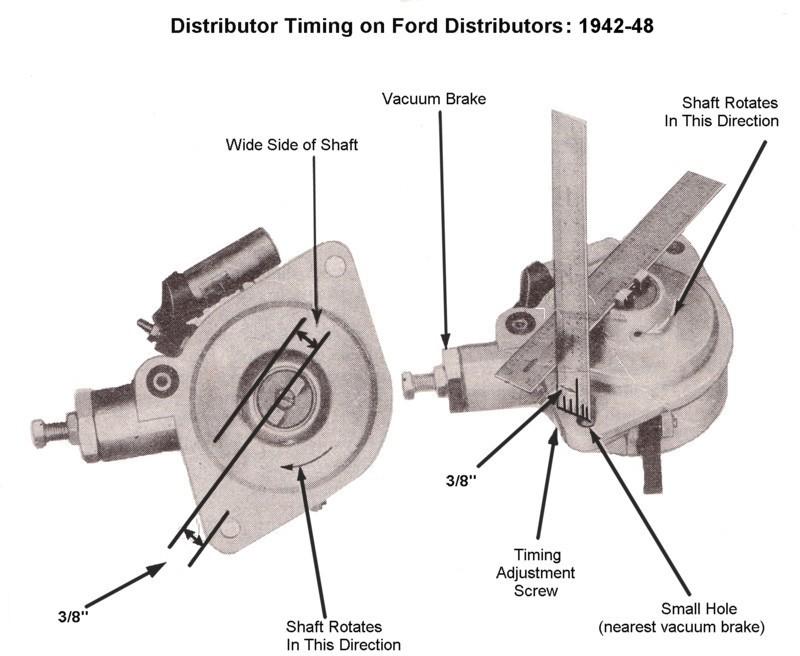

Don't feel bad about leaving the ignition switch on. I did it this summer for the first time since owning 42-48 Fords since 1973. Coil had oil boiled out of it and distributor points were pitted. Is your coil the original one with the ford script or a round one? If it is going to start good distributor needs to be timed correctly. Charlie Schwendler in NY. can do that for you and it will be 100%. His number is 716-662-9159. He also rebuilds Carbs and fuel pumps so the ethanol isn't as much a factor. Skip Haney can rebuild an original coil. I found my battery cables had "green" inside when an end snapped off one day. Looked good from the outside. Consider replacing all and clean all connections at a minimum. P.M. me anytime and I'll try to help you. Ditch the 8V battery, if everything is up to snuff the 6 volt system is fine. People that had these cars drove them everyday and didn't own them because they were unreliable!
