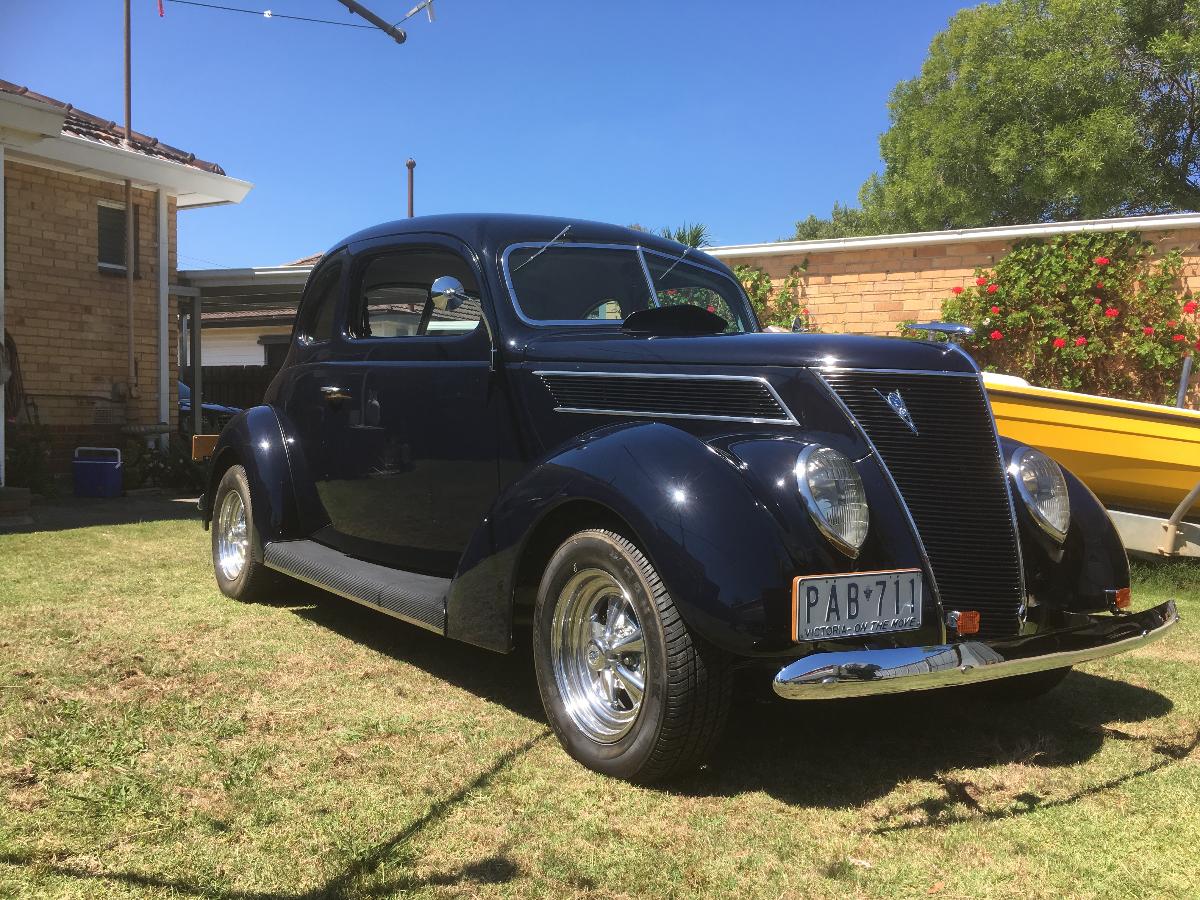

I have a 6 volt 37 club coupe that has a electrical discharge with the ignition turned off, I have never noticed the discharge before today, any ideas would be appreciated thanks in advance
