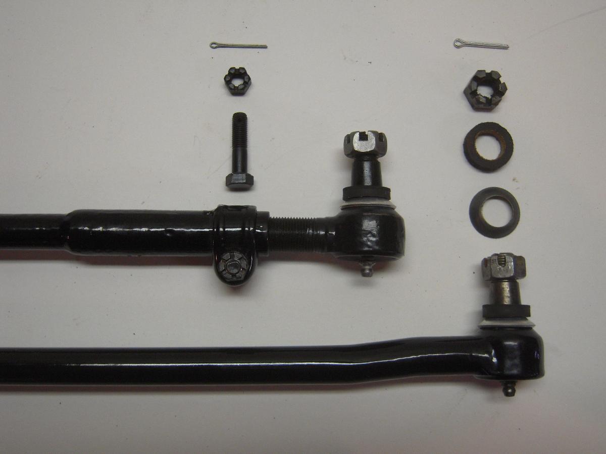

kubes40 | -- 10-31-2021 @ 5:41 AM |
Peter, If I am understanding your post correctly, you are searching for the rubber part of this "assembly. Correct? If so, heater hose from your local NAPA will work perfectly. Cut it to about 3/16" thickness. Mike "Kube" Kubarth
