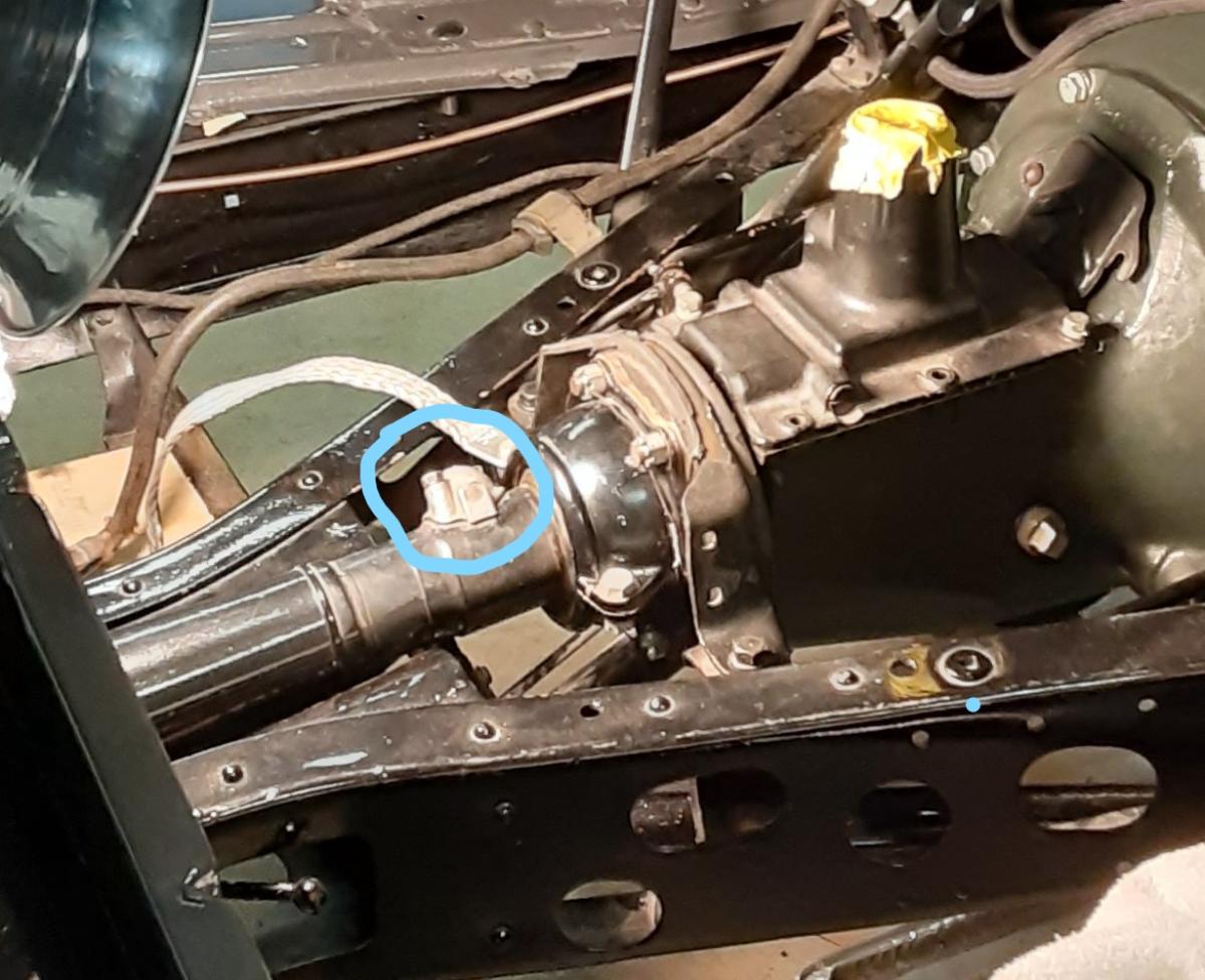

If you think it is the speedometer gear, then you will have to remove the floor mat and floor. I have attached a picture with the speedometer gear circled. Two bolts hold it in place. There will be a number on the casting, that is a reference to the drive shaft gear and if the housing is damaged, you will have to find one with the same number.

Thanks nelsb01 and 37RAGTOPMAN for your replies. I won't beable to work on the car for another week. My first plan of attack is the speedometer. I hope this is the issue as I am not a fan of removing the floor. Thanks for the pic and information regarding the gear ratio reference. Using the square head drivers from my drill set is a easy and great idea. If it is the speedometer where would I lub it? Thanks in advance. Ray

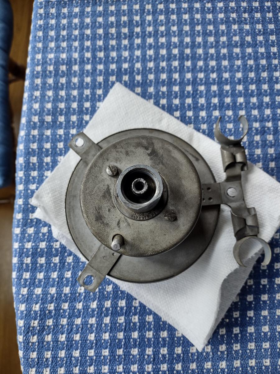

Dream38v8 | -- 10-31-2021 @ 11:16 AM |
TomOand 37RAGTOPMAN, I removed the speedometer. Checkout the attached picture. I do not see any place to lubricate the speedometer. I have two questions; 1) which direction does the cable turn at the speedometer head? Clockwise or counterclockwise? 2) How hard should it be to turn with a square drive? Using a square drive and pliers it was extremely tight. Ray
