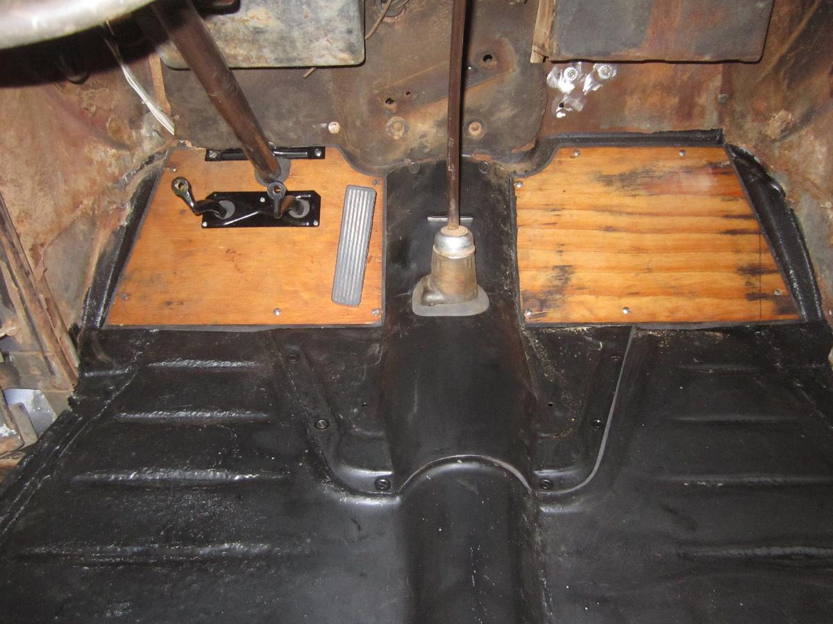

Mike, Not sure I understand what the "inspection plate" is. Attached is a pic of my 37 Fordor floorboards. gregg

I meant the cover over the transmission. Just called it an inspection plate, because you can inspect the under stuff. Thanks for the picture. Looks like you have to remove the floor boards to get this plate off, no matter what you call it. Thanks, Mike

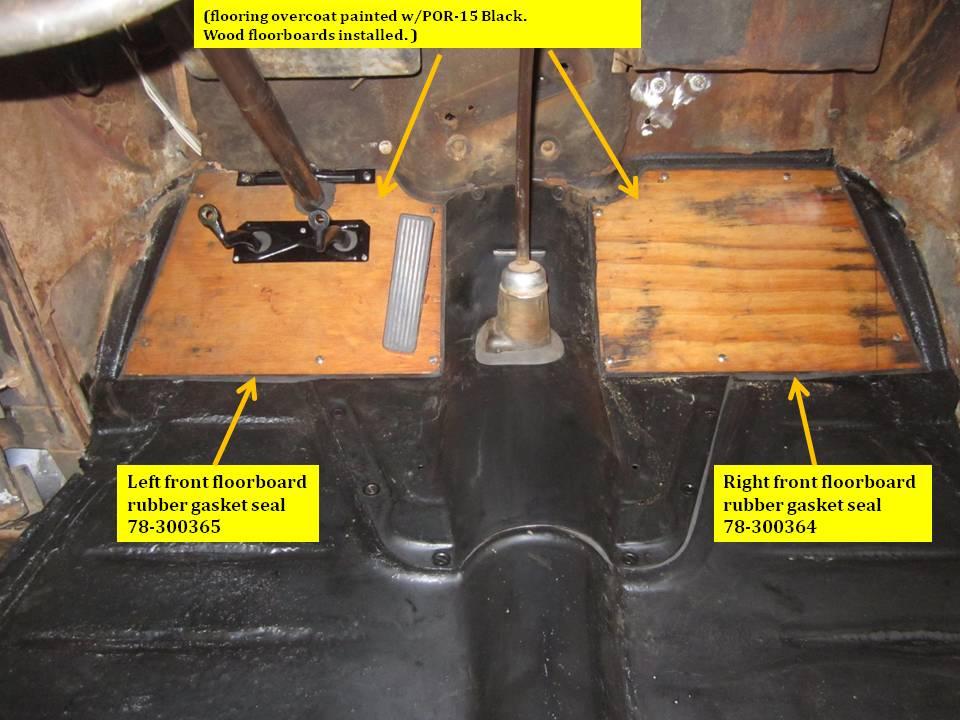

Transmission cover goes in first and then the wood floorboards. The trans cover also has a seal where it mates to the steel floor pans and transmission tunnel.

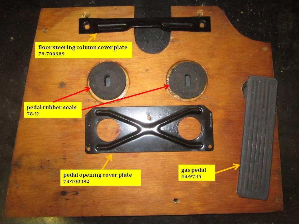

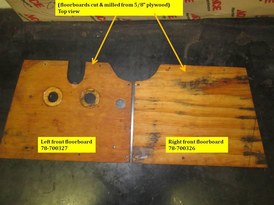

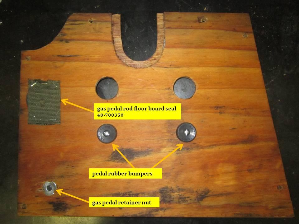

And here are a few more pics. gregg

Thanks for the pictures, very helpful, Mike
