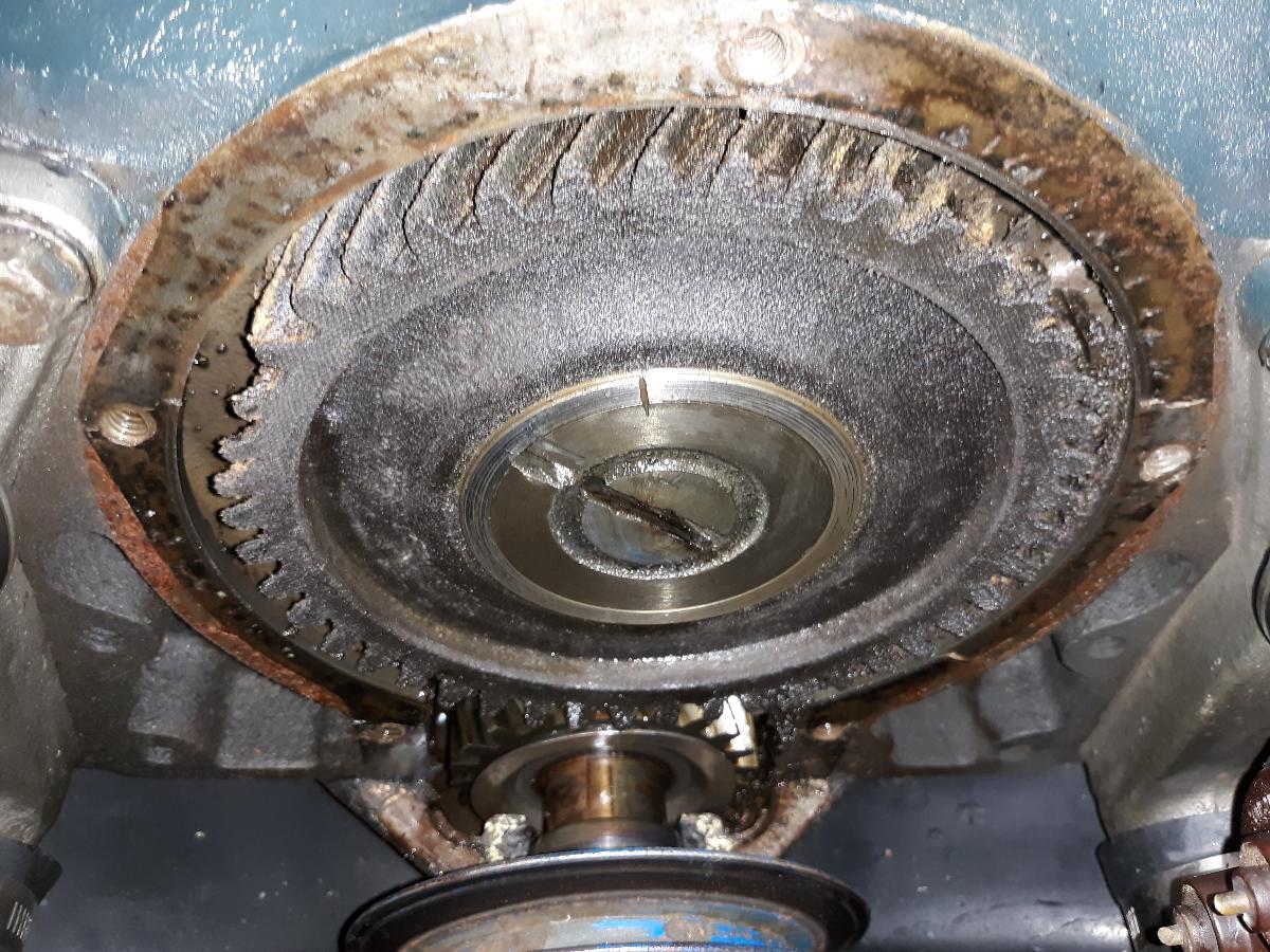

39Fordfan | -- 10-05-2021 @ 6:22 PM |
The timing gear on my '39 Deluxe shredded itself the other day while I was at highway speed. It looks like it's the pressed on type, not bolted on. It seems I'm in for a big job ahead of me. Unless you have a way around pulling the engine and tearing it down to press a new timing gear on? I'm thinking I'll pull the engine myself and figure out what machine shop I'm going to. I doubt I would rebuild it myself, but maybe it would make sense? I've never traveled down this road before, this was my Dad's car. I'm pretty sure Henry's guys were the last ones to ever touch this part of the engine. I'm wondering if you can give me some tips about; A) Pulling the engine. B) Questions to ask an engine rebuilder. C) Can you even find the parts needed during this pandemic? Can you get a better timing gear than this fiber type? D) The engine smoked a small amount on acceleration, and yet it pulled really strong. I'm not sure it needs a full overhaul? But it seems if I'm going to go to all this trouble it would be the wise thing to do. E) Any idea what it costs to rebuild a flathead these days? Or recommend a good flathead shop in the Midwest? Thanks! I really appreciate it. This message was edited by 39Fordfan on 10-5-21 @ 6:31 PM

I would pull the engine to replace the timing gear. The gears at the back of the camshaft operate the oil pump and you could have a problem getting them to mesh. I would not install a new camshaft in the old bearings, it could cause oil pressure problems due to bearing clearance. Any competent automotive machine shop can press on a new gear for you. Your photo shows the press on gear. If you are going to rebuild the engine, then I would get a camshaft with the bolt on gear. You need to provide your city and state in your request for an engine rebuilder. The 39 engine may have the thin steel sleeves and it is usually a good idea to replace the sleeves. Machine shops that are not familiar with the flathead V-8 have problems working on the engines with the steel sleeves. Most of the engines that had the sleeves had HS stamped on the machined surface where the intake is mounted. Look at the front of the engine first as that is the most likely place for the stamp. Tom

I also would inspect the CRANKSHAFT GEAR, this is most likely what made the CAM GEAR GO BAD, probably has rust pits in it,or rough surface on the teeth on the gear, the engine I replaced the cam shaft, was rebuilt , had no roblem lining up the oil pump drive gears, my 2 cents 37Ragtopman
