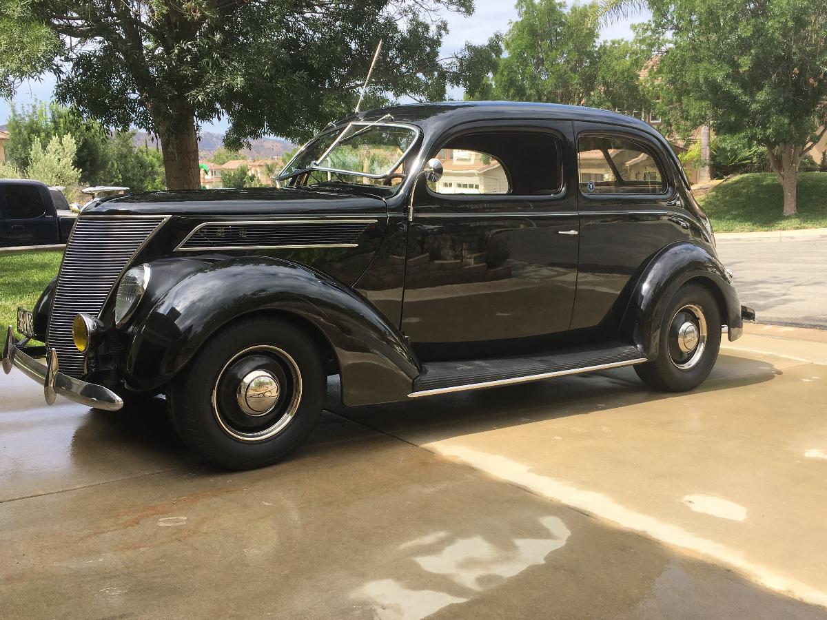

I have a '39 Top Loader mounted to my built 59AB. The '37 Trans that was replaced with the '39 Trans was a ten spline, so I am thinking that they are the same. However, I see that there are three sizes of clutch/pressure plates and I do not know which Clutch Assembly to purchase, due the car being my daily driver, I would much rather buy parts ready to install to avoid having to use Uber for several days waiting for parts.
