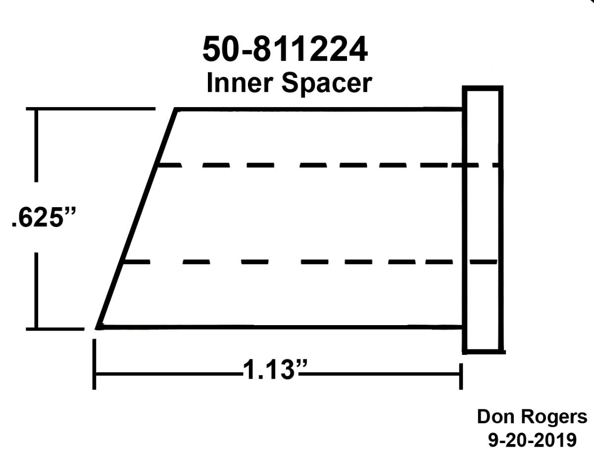

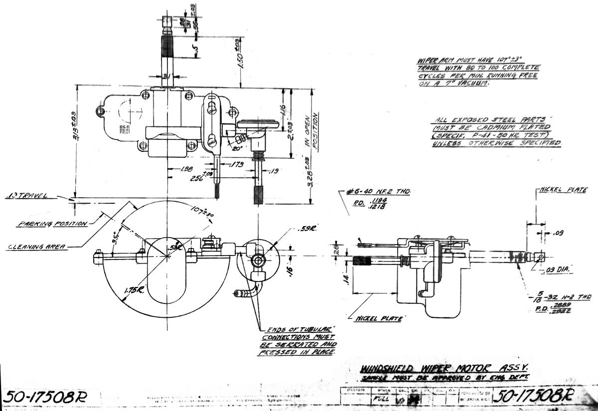

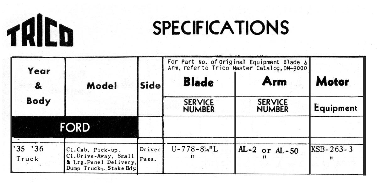

CDemarest,The motor that you are looking for is a Trico KSB-263-3. (Ford # 50-17508) It fits all 35-36 Ford trucks. Ford did not use (2) wiper motors. If you wanted a wiper blade on the passenger side it was slaved of the driver's side wiper arm. Ford and Trico had a kit for this. Here are some images that should help you find what you are looking for.
