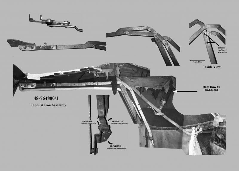

I have a set of top irons, but I can't figure out how they attach or work, or if they are the correct ones. Is there any information, sketches, photos or other information that can help me? Thanks
40 Coupe | -- 07-30-2021 @ 4:12 AM |
Post some photos of the top irons. They typically attach to the back of the B pillar and the area around the heavy belt rail in the rear, on both sides of the car.
flatheadfan | -- 07-31-2021 @ 5:16 PM |
This might help. Tom
