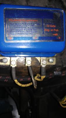

You should still check to make sure that the conversion was done correctly. You said the 12 volt system was POS ground, that make me worry that about if it was done correctly. The original 6 volt ignition coil required an external resister. It is mounted inside the car on the left side of the fire wall. Some 12 volt coils require an external resister but it is probably a different value than the Ford one. Other coils do not require a resister. All 12 volt coils are NEG ground. The gauges require a voltage reducer and regulator to give reliable readings. You should make sure that the correct voltage reducer was installed. Tom
Ramblin Reck | -- 07-18-2021 @ 5:29 AM |
Found this on mounted on the firewall:
