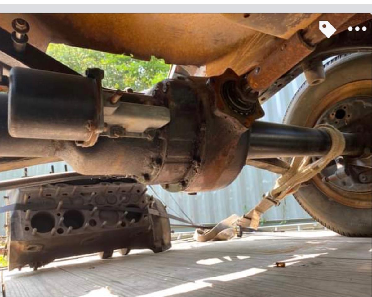

Can I use a 47 Columbia in my 34 sedan? TIM CARLIG
kubes40 | -- 07-05-2021 @ 7:22 AM |
Well, yes. However, if I may offer some advice... Have the Columbia (right side ) axle housing modified to "make it" a proper '34 housing. John Connelly does this task beautifully, promptly and reasonably. With the proper axle housing and the original left housing, you may use the center section from the '47 Columbia. At that point, it's a simple matter of installation. Controls? If it were me, I'd seek out a correct set. I believe John can supply all or nearly all of the required components. Mike "Kube" Kubarth
dean333 | -- 07-05-2021 @ 8:36 AM |
Thanks Mike. TIM CARLIG
40 Coupe | -- 07-05-2021 @ 9:34 AM |
If you do as Kube suggest and decide to use the 34 center housing you will need a spacer which John also has, due to the 34 housing is slightly thinner than the 47. John has all the gaskets, seals and parts and controls. You will also need to use both 34 axles and spiders.
dean333 | -- 07-05-2021 @ 5:45 PM |

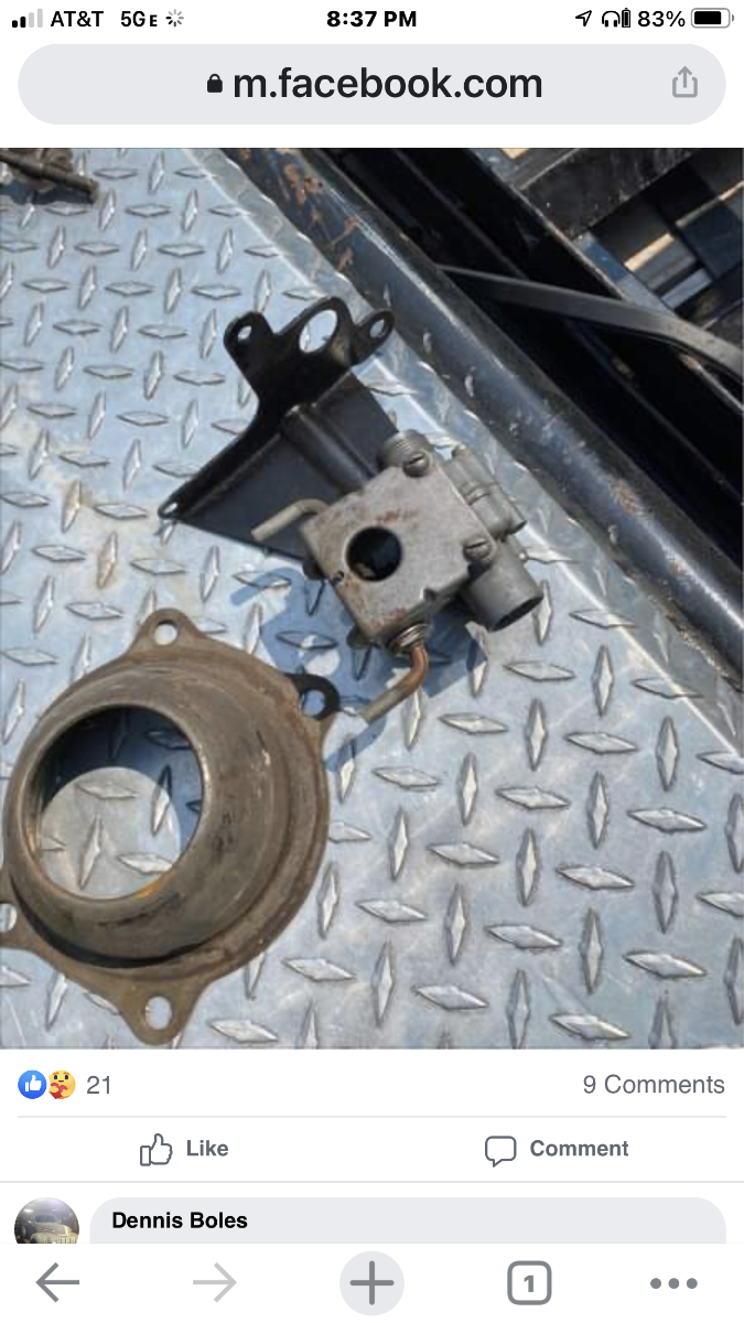

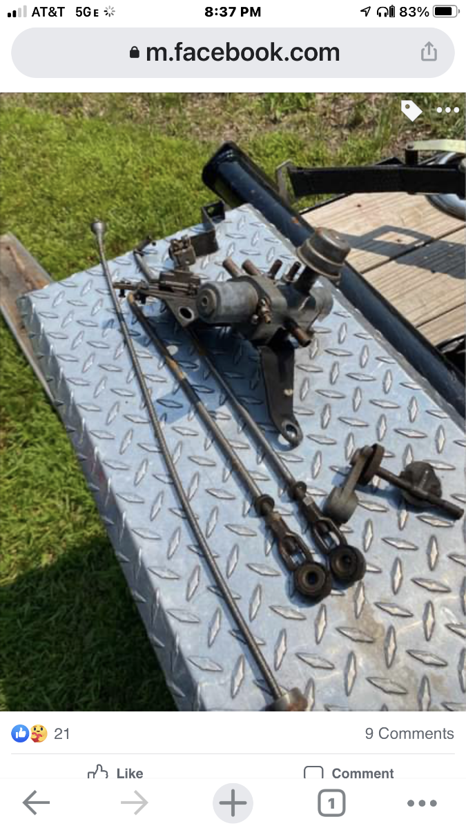

What’s a fair price to pay for one without the dash controls?? TIM CARLIG This message was edited by dean333 on 7-5-21 @ 6:43 PM
wmsteed | -- 07-08-2021 @ 8:21 AM |
The Columbia controls you are showing in your pictures are the electric over vacuum type for the 46-48 Ford vehicles. A Columbia in a '34 is not a correct application, especially since you will be using a modified '47 Columbia.. Do yourself a favor, use the '47 controls on your car, they are more user friendly compared to the earlier mechanical switch. I have a '47-48 Columbia under my '36, it was a bolt together application using a combination of '47-48, 36 and '37-38 parts. i used the vacuum/electric shift controls mounted to the inner fender panel in lieu of the left engine head. I did not note a clutch safety switch assembly in your collection of parts. A very important item. Bill 36 5 win delx cpe
kubes40 | -- 07-08-2021 @ 11:52 AM |
The one in the photo? If you feel lucky, no more than $750. Mike "Kube" Kubarth
