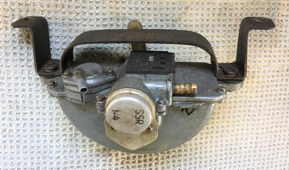

51woodie | -- 05-26-2021 @ 3:08 AM |
I had to replace the wiper motor on my '46 Coupe two years ago, with an almost NOS, and it works great. I tried the "lube in the hose" as suggested by several posts, but I can't understand how it would work, and for me it didn't. In my old mind, any lube put in the hose would be sucked into the carb base as soon as the engine was started. What detail in the process did I miss? Should I have put the lube in the hose that runs from the the control valve (connection on the left in pic.) to the motor, instead of the line from the carb base to the motor?
Jacques1960 | -- 05-26-2021 @ 4:59 AM |
The motor is one thing, the diminutive wiper blades yet another !
Jacques1960 | -- 05-26-2021 @ 5:01 AM |
The purpose of introducing lubricant (brake fluid, ATF, etc.) is to rejuvenate the internal diaphragm. Generally works extremely well.

51woodie | -- 05-27-2021 @ 1:44 PM |
Maybe I hijacked Mark's post, but I'm still wondering about the question I asked, on the process to lube the wiper motor. Where to put the lube?
MG | -- 05-27-2021 @ 2:00 PM |
I removed the rubber vacuum hose from the base of the carb and sprayed the lube directly into the hose. The oil spray can did have the long red plastic tube on its nozzle....Worked like a champ.... oops,,,,I forgot to mention that I did operate the wiper arms manually a couple of times back and forth before I reconnected the vacuum hose to the base of the carb.... This message was edited by MG on 5-27-21 @ 3:51 PM
ford38v8 | -- 05-27-2021 @ 3:55 PM |
51woodie, the vacuum hose can be removed from the engine side, and spray oil into it while manually operating the wiper motor. Any oil will work if the internal blade is not totally shot, but remember that the engine will be the ultimate recipient of what goes into that hose. A rebuild of the wiper motor will work wonders for it! When working properly, the control knob will function as a speed control, from dead slow to h*lla fast. Alan
