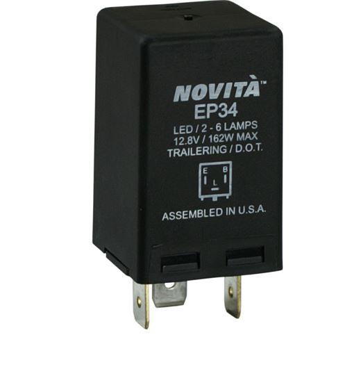

Steve Kennedy | -- 05-13-2021 @ 9:29 PM |
I have LEDs all the way around. I use a NOVITA EP 34 flasher. It does not need a Load, but is electrically cycled. This message was edited by Steve Kennedy on 5-13-21 @ 9:30 PM
