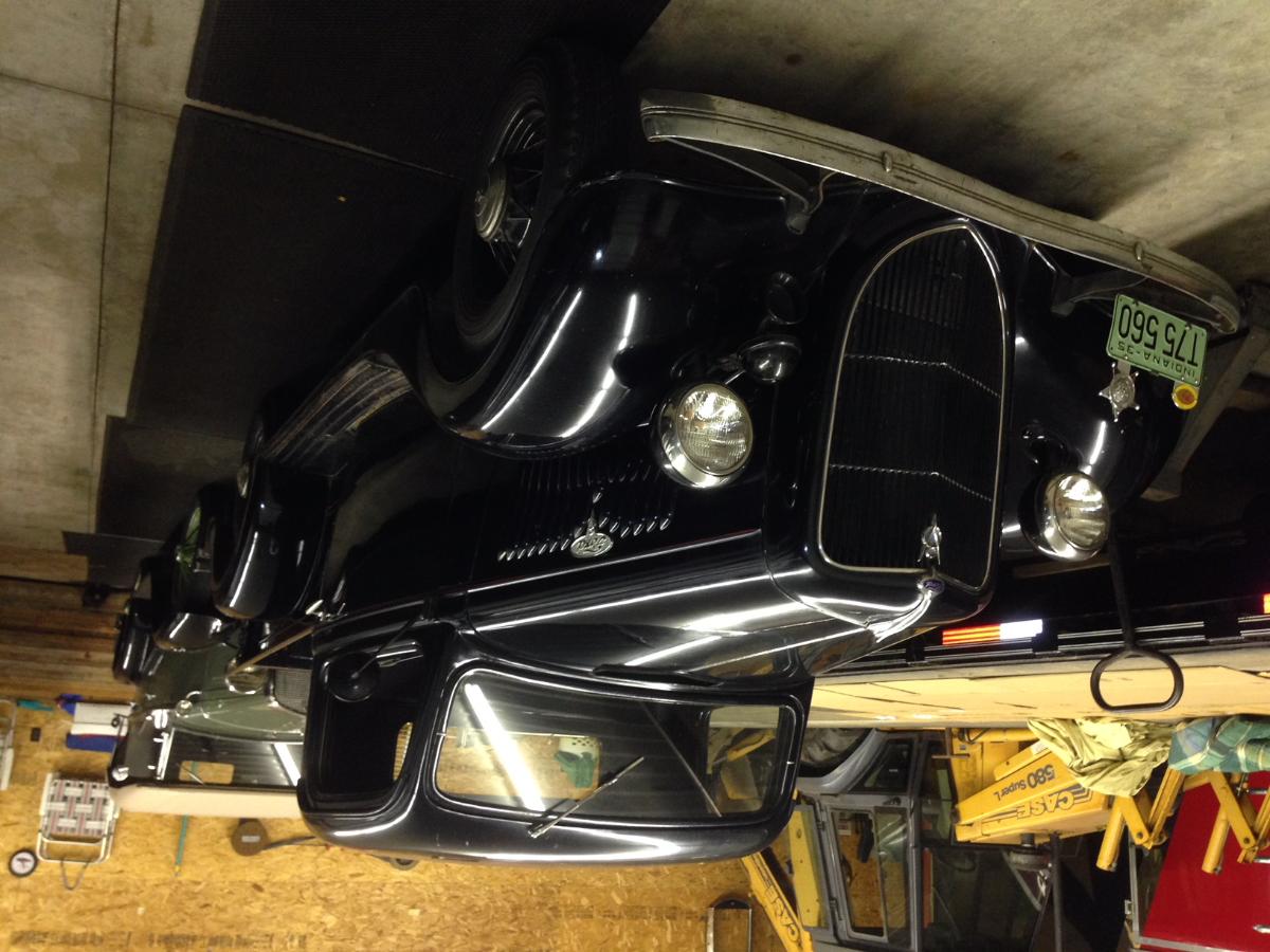

I installed LED headlights bulbs on my 35 Pickup. (Someone had installed sealbeams) And the LED's work great, but sometimes they will start blinking like a strob light. The car still has the original 6 volt generator with Positive ground. The LED's are for positive ground and 6 volt. Has anyone had this problem and if so, what fixed it. thanks, Jerry
