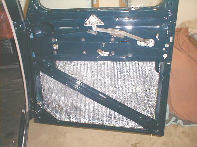

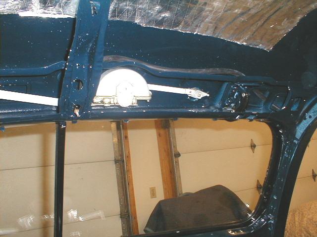

Gary, there are three holes behind the headliner that will accept the visor bracket screws. I suggest you feel for them and when you think you have them, push a pin through just to be certain. The "large" hole in the body (behind the liner) that is meant for clearance of the bracket pivot is more easily felt. Once you are confident you have found it, you'll need to slit the liner with a razor. Installing the arm rest(s) is going to be a bit trickier as your door panels will not have clearance holes in the backing for ease of figuring the proper location of the three screws that secure the rest to the door panel. I trust you have the necessary bracket with the arm rest(s). There's a "slot" in the inner door structure that the arm rest brace slips down - in to. In my photo, you can see it in the approximate middle, at the very bottom of the inner structure. In the second photo, to the far right, you can see the holes for the visor. Mike "Kube" Kubarth

Actually I do not have the brackets for behind the door panel. From your pics it looks like once the armrest is mounted to the door panel with the backing plate, the backing plate itself hooks over the support on the door then the door panel gets remounted. Yes it will be difficult to figure out exactly where the armrest is placed. Hopefully I can find a diagram of the exact placement of the screw holes. Thanks for the info !!

If your car was originally built as a standard model there may not be a bracket above the headliner for the RH sun visor.
Gary M. | -- 03-13-2021 @ 5:07 PM |
It is there, I located it by pressing against the headliner.
kubes40 | -- 03-13-2021 @ 5:42 PM |
There are provisions for two visors in all '39 passenger car models . Mike "Kube" Kubarth

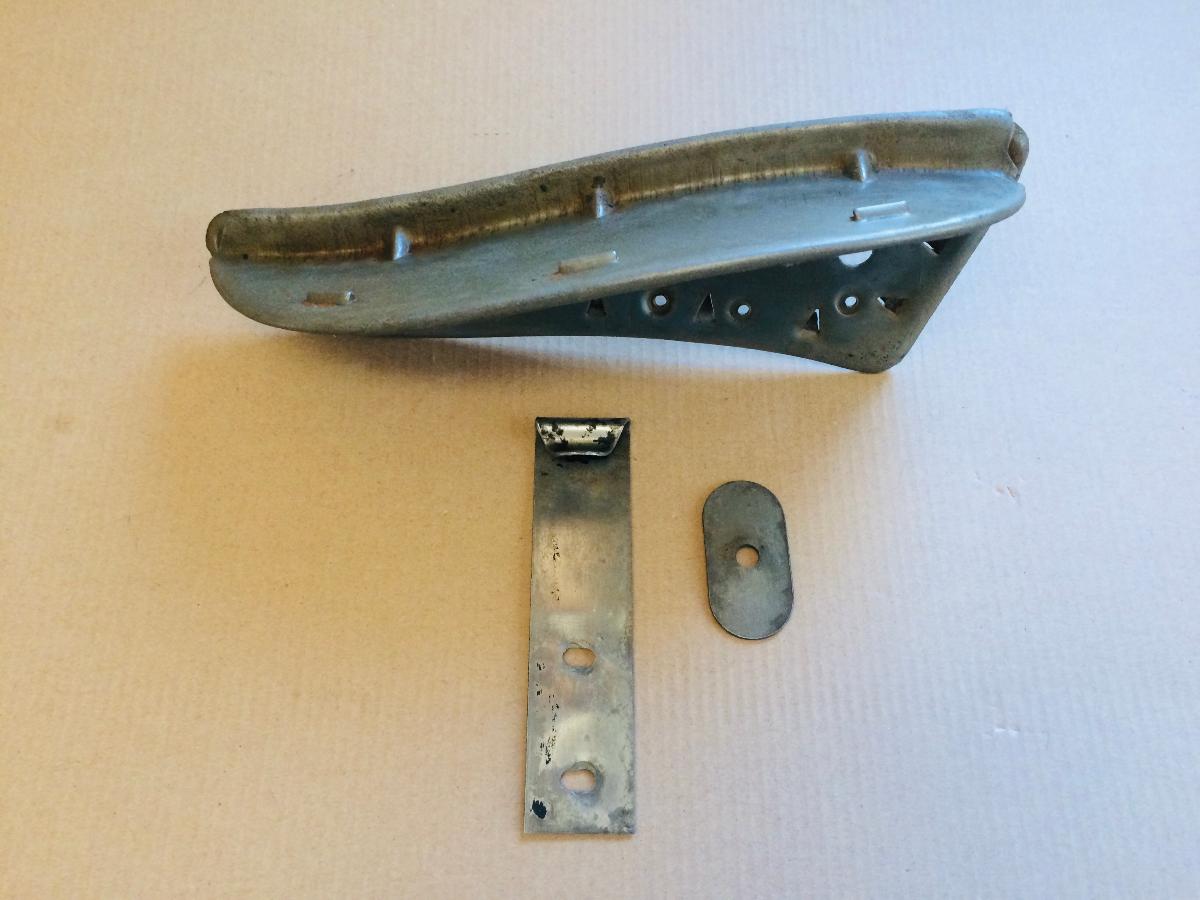

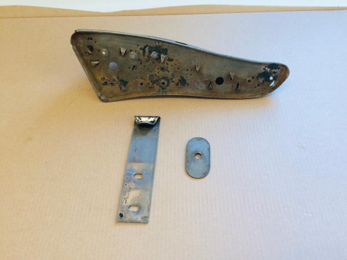

See attached photo it shows mounting brackets.

Wow, thanks, very helpful ! The person I bought my car from installed a Lebaron Bonny interior. Do you know if the replacement door panels would have a drill hole template printed on the backside of the panel ? I have not yet removed the panel. Thanks...
