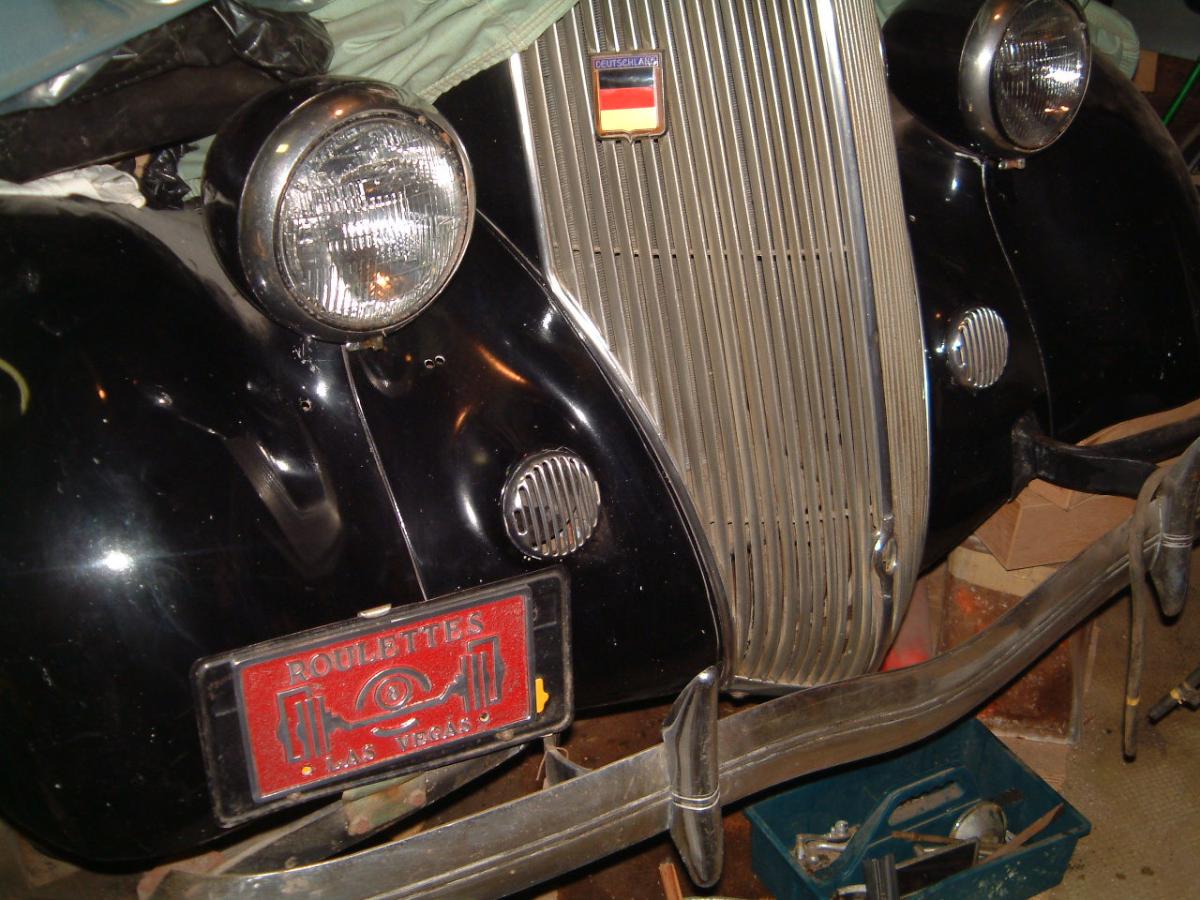

I have to remove the grill on my 36 for some repairs and also replace the welting on the horn panels. Can I remove the grill assembly and both horn panels as a complete unit from the fenders after removing the headlights? Thank You. Frank

I had to remove the radiator to get to some of the bolts. Be sure to either mark, make notes or take pictures of which way the bolts go in. Some nuts are on the grill side, others are on the fender side.

You should be able to remove the grill and horn panels as one unit. I believe you will probably have to remove the headlights.

Thank's Steve, I know the grill bolts are hard to get at, but I wanted to take the grill off with the horn panels since the bolts that attach the horn or inner fender panels are easy to get at. Frank

You will have to remove the headlights because the mounts for same straddle the fender and horn panels. Bill 36 5 win delx cpe
