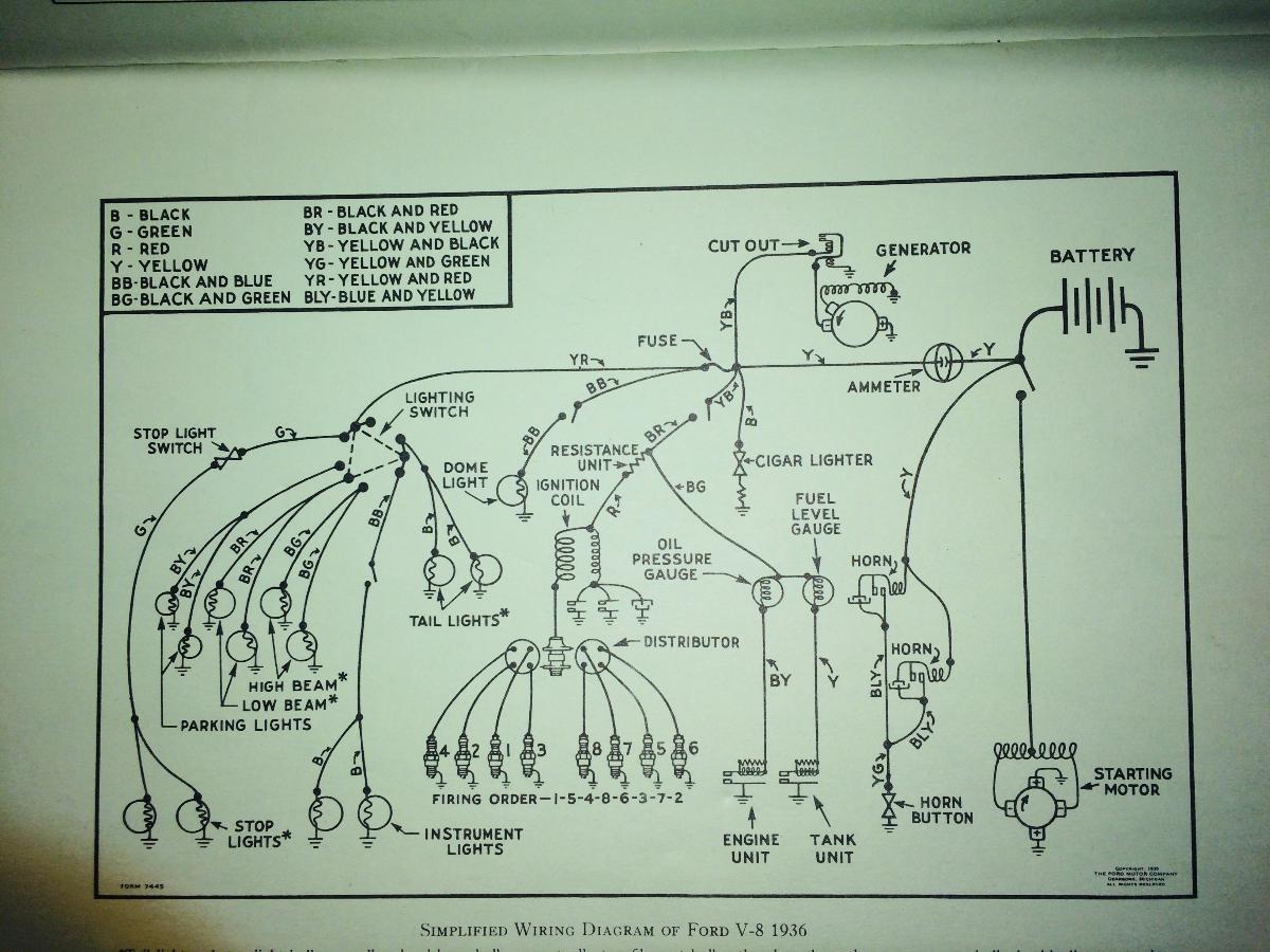

Do you have the Ford Reference Book for 1936 Ford V-8? Some call it the Owner's Manual. That has the wiring diagram in it. The harness at the end of the steering column is a twist and pull off attachment. Clean it up and you should see an 'L' stamping in the casing. Twist it slightly and then it should pull off. Once cleaned, put on some 'gripper' gloves and that will help you twist it off.

See attached.

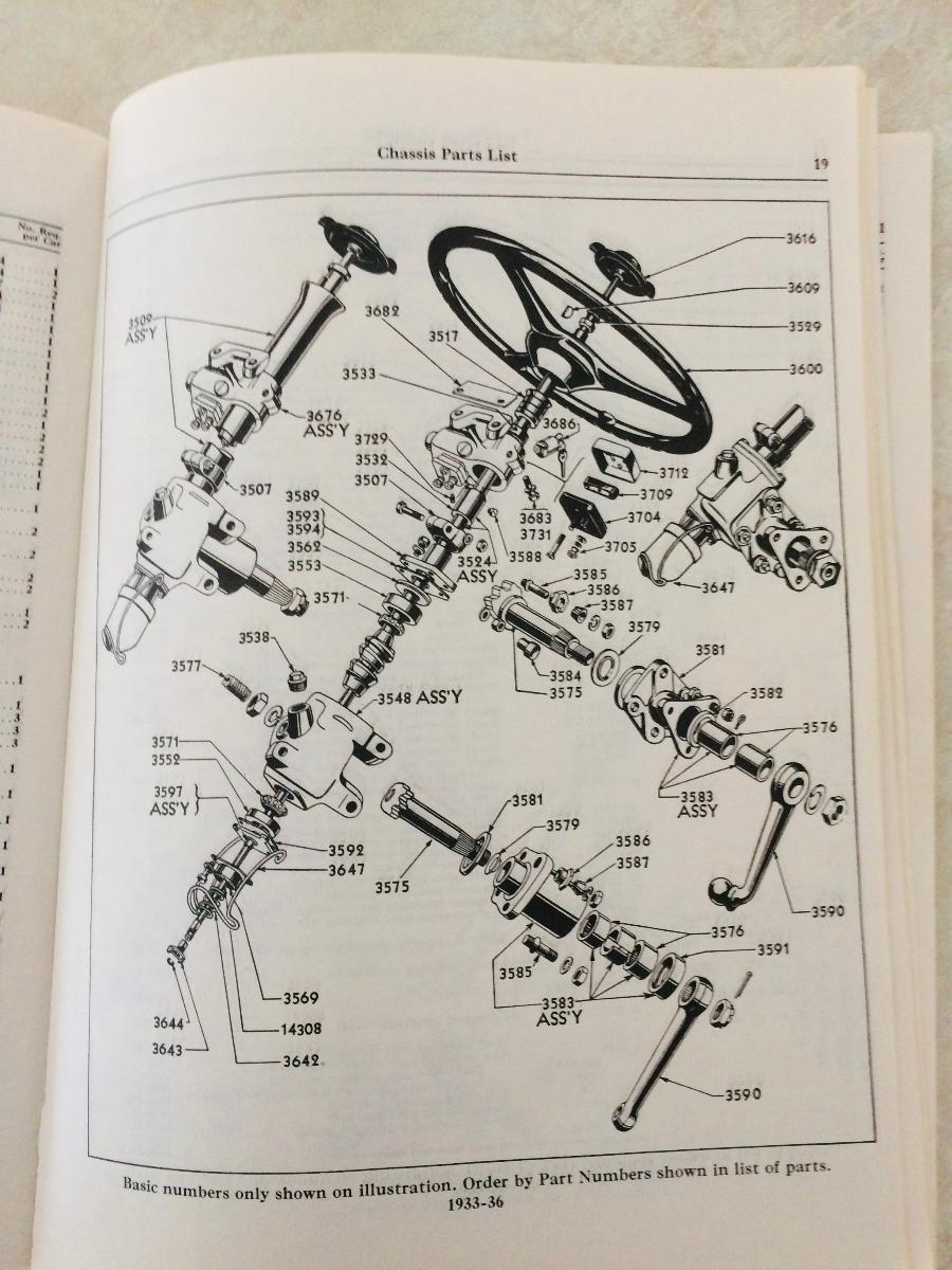

See attached.
