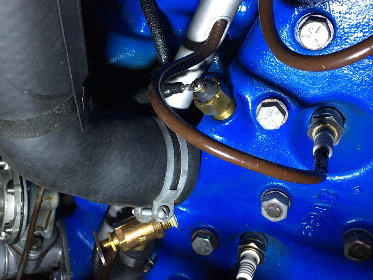

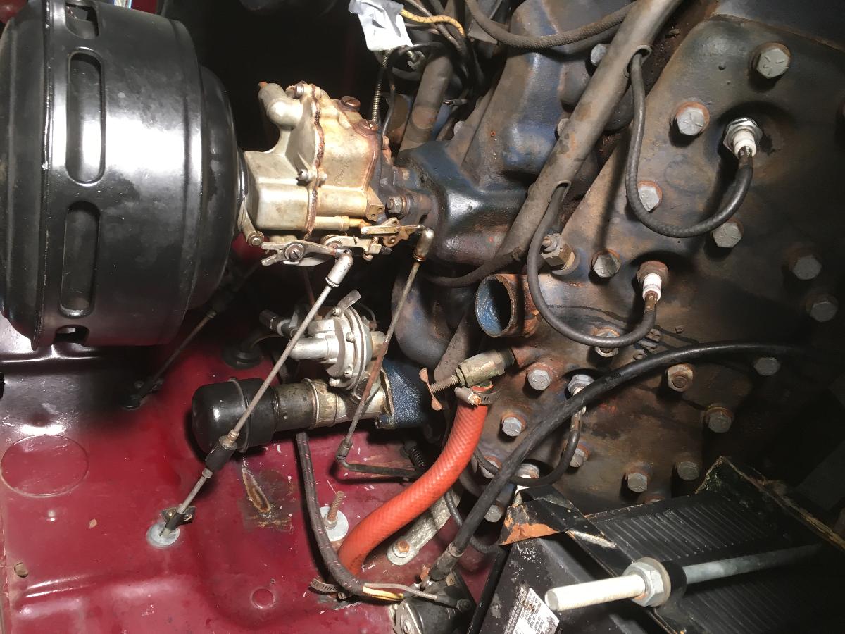

51woodie | -- 01-25-2021 @ 3:23 AM |
srg. The thermostats, if there are any, sit on top of the hose spigot on the top edge of the cylinder head. I use 180 deg. stats in my 59AB, and it runs good with no overheating, even in slow traffic. There are several posts on here and the Ford Barn about stats, and how to secure them in place. I used short pieces of hose that fit tight inside the rad hoses to keep the stats from moving away from the spigot or turning sideways. Others put a second clamp on the hose just above where the stats sit, to hold them. Need to figure out how to keep pics from turning sideways This message was edited by 51woodie on 1-25-21 @ 3:28 AM
