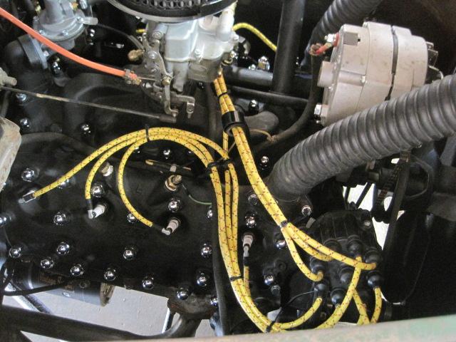

Another option is a set of EAB heads. Better performance than 8ba or 8rt heads. If you want the bling look, use chrome acorn nut covers on the head bolts and manifold bolts as well. The ones I used on the EAB heads on my 8ba fit a bit loose but a little dab of silicone solved that issue. ______________ No signature
