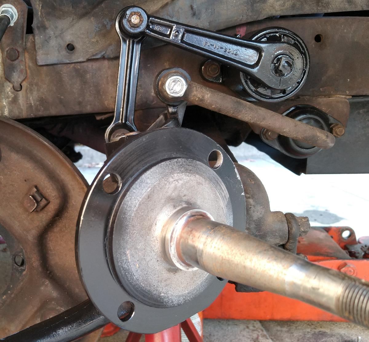

Supereal, The new sleeves have holes in the for the grease to enter from the zirc fittings. I checked the zircs to make sure that grease would actually go through them before I mounted the spindles on the car. I made sure that there was grease in the sleeves as well before I re-assembled things. Both spindles are now mounted, the re-built tie rod is installed, as is the un-re-built drag link (that will get replaced when I do the steering gearbox. If I work all day tomorrow, I might get it all back together. Once it gets a short test drive, I will re-orient it in the driveway so that I can get to the steering gearbox and rear shocks more easily (the rear shocks will be re-built next). Thank you to everyone who provided answers/assistance! This message was edited by RAK402 on 1-11-21 @ 11:18 PM
