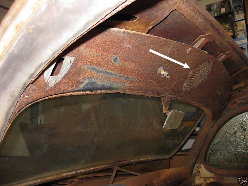

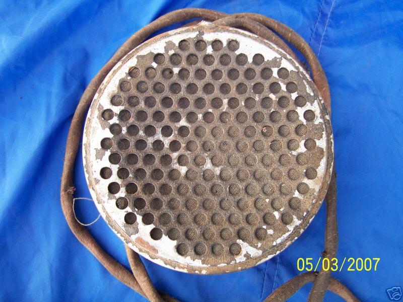

pinnsky | -- 12-19-2020 @ 7:24 PM |
The 36 closed car speakers were over the windshield behind the fabric cover. There is a knockout in the steel panel the covering the wiper motor. The fabric covers the speaker which has a grill over the speaker cone

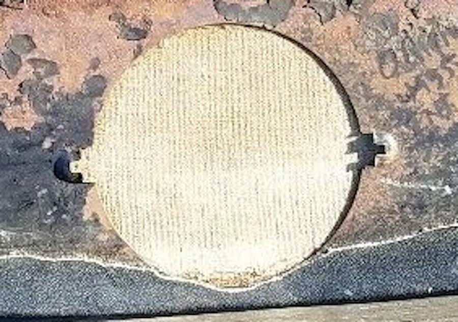

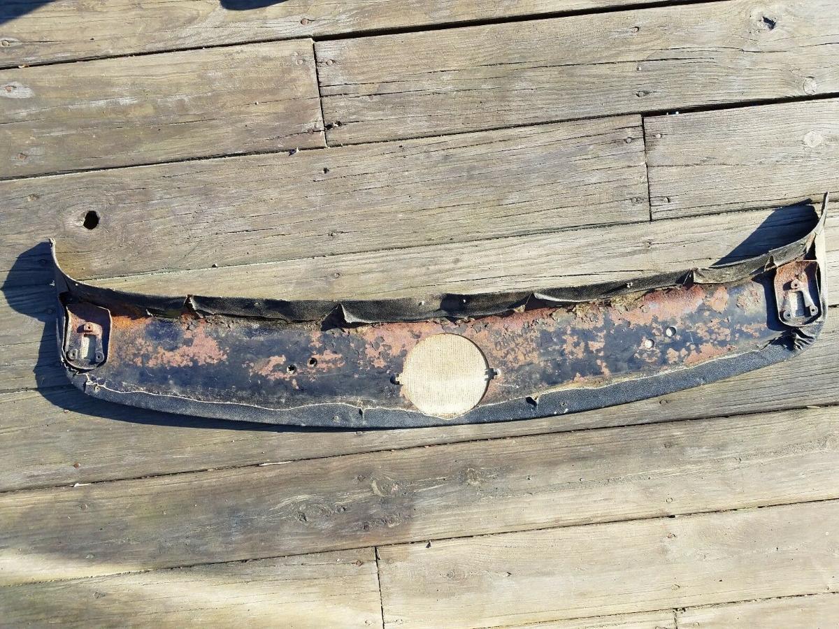

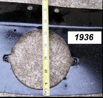

Don Rogers | -- 12-19-2020 @ 8:41 PM |
Here are some images of the speaker, the hole in the header panel and the speaker mounted in the panel.

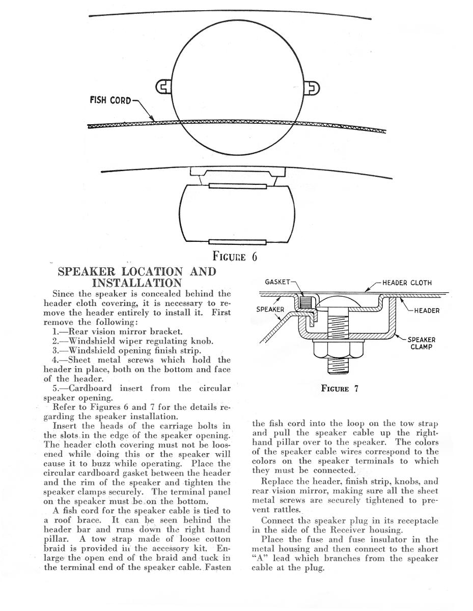

camsaure | -- 12-19-2020 @ 10:12 PM |
Perfect, Thankyou very very much. I suspected that may be the case, but it was only a guess on my part. One more question though: What held the speaker in place? I suspect the hardware would be hidden as well??
Don Rogers | -- 12-20-2020 @ 7:45 AM |
Here's a composite from the 36 radio installation manual that should cover everything about mounting your speaker.
camsaure | -- 12-20-2020 @ 8:06 PM |
Thanks again, I understand it all now. Very helpful folks.
Steve Kennedy | -- 12-21-2020 @ 6:36 AM |
Look close and you will see a place for a carriage bolt.
