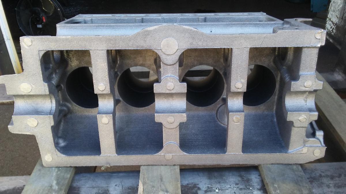

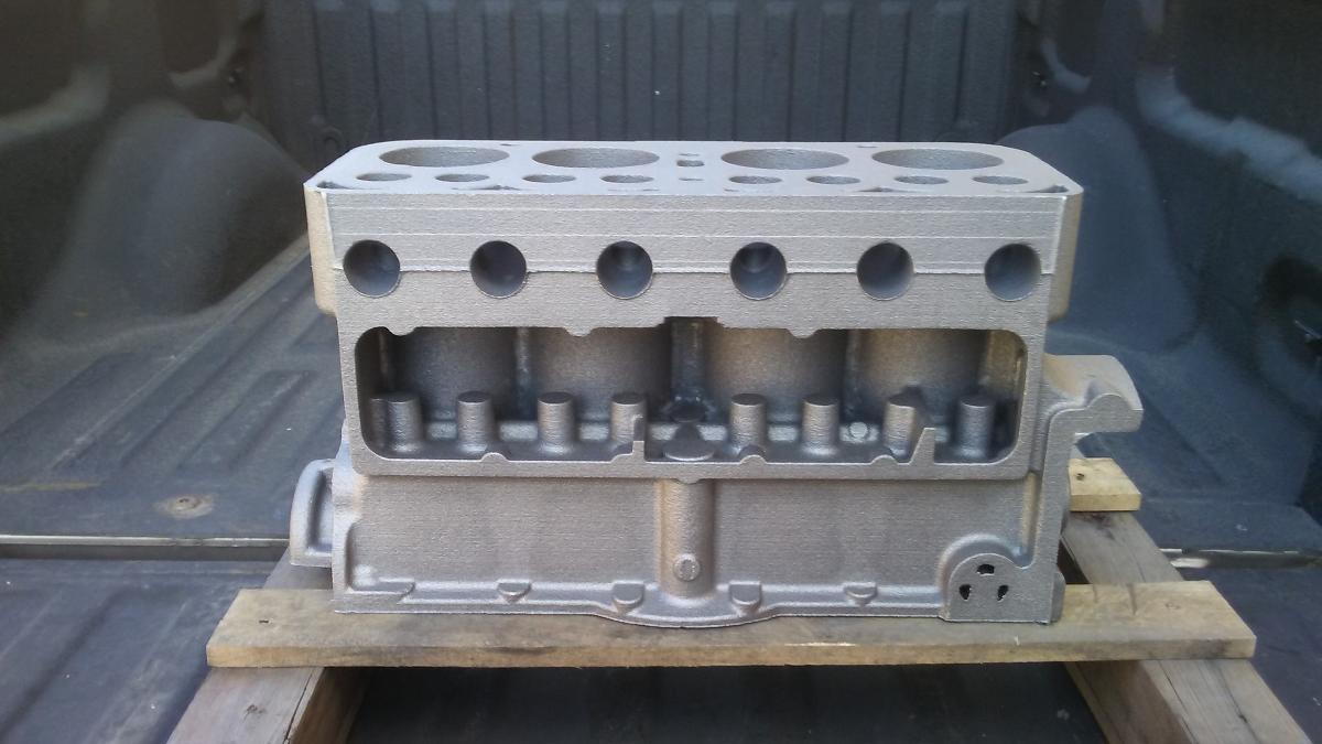

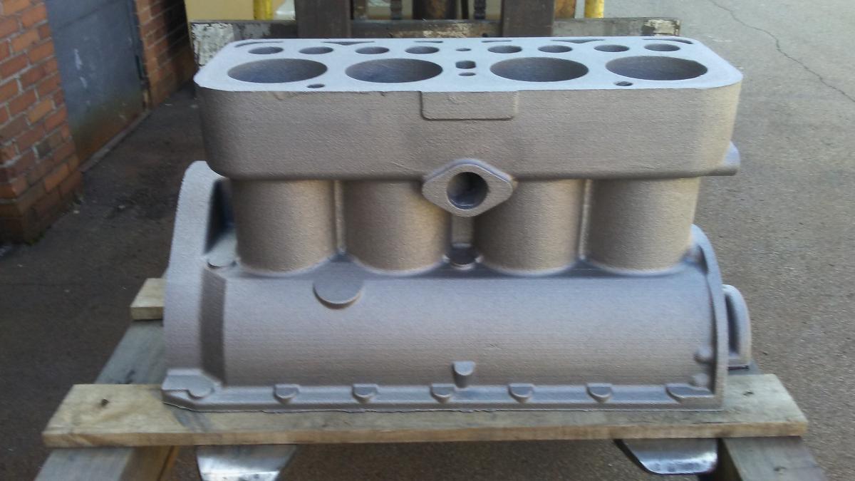

Thanks for the add. I wanted to join this forum to introduce myself and a recently started effort to produce an 8BA engine block. Most of my exposure of the project has been on The Ford Barn and Face Book so far. I have Model A blocks under way and the 8BA is next in line. I can post a few pictures of one of my 5 main iron Model A blocks showing the kind of casting one can expect when the 8BA is cast if anyone is interested. Tod
