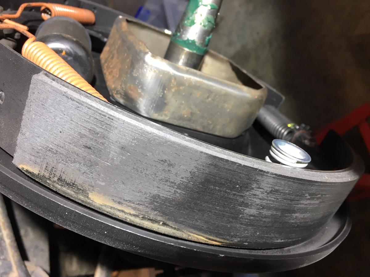

I put new locally purchased front brake shoes on my 48 Merc. The drums are 12 inch, and have never been cut oversize. The drums would not go over the new shoes. I had the shoes "arched" .020 on the dia, and everything went together ,OK. With the new shoes and for 1ooo miles, the brakes do not stop the car very well( major brake pedal pressure needed) and fade on stops from 70 MPH. Any ideas what went wrong and where I can get brake shoes that fit standard size drums and will stop better? The car was fine before I did the brake job 2 years ago. Bill Large This message was edited by blarge on 10-11-20 @ 2:22 PM

1) Are the drums truly round? 2) Are the drums glazed? 3) Did you have the shoes arced to the actual diameter of the respective drum? To do this properly, one must accurately measure the respective drum and cut the shoes to that size - not an arbitrary .020". It seems difficult to believe if they (drums) have never been cut that they are truly round and not glazed. Linings may be too hard. Mike "Kube" Kubarth

I would suggest that you pull the front drums, and have a look at the shoe contact pattern. When I put new brakes on my '46, they didn't work as they should have. I pulled the drums, and found about 40 - 60% contact on the four wheel ends. As there are no shops to arc shoes in my area, it came down to hand sanding the high spots. Much better contact and brakes after several rounds of sanding.

I just had the same issue with my '47 Ford 2 door sedan. After a lot of trial and error found out the work I did was fine but Ecklers/Mac's sent the wrong shoes. When the shoes are arc'd the radius of the shoes surface should match the inner diameter of the drum. I measured and found the contact point at the top of the shoe was just about touching the drum and the bottom of the shoe had an 1/8th gap between the shoe and drum. My car has the standard Lockheed brakes not the self energizing Bendix brakes; I think your Merc has the Lockheed brakes as well. This message was edited by cdeac47 on 10-12-20 @ 2:08 PM

Hi Bill, give me a call, I have the gages to measure the shoe radius and the drum diameter. Paul in Jackson

If the shoes have bonded linings, it is likely they are too hard. That is OK for non-power brakes, but not for our old cars. Usually the clue is that the shoes are not riveted if they are incorrect. Regards, Bob

blarge. If your drums are true and round, why would you cut them OS? All due respect, it would be better to have the linings arced to the correct diameter. You can get new shoes/linings, but once you cut the drums you cant go back. Just my opinion.

I have the same question. Why cut the drums? Replacing the shoes is far less expensive than drums. Additionally replacing old brake drums with new ones is a big and costly ordeal. As I said in a earlier post check the shoes to make sure they are the proper ones and arc them first before cutting the drums!

Hi Bill! You might try the woven livings. C&G shows them for your gorgeous Merc as 21A2001-NBD, $69.95/set. That also includes the rivets, I used a set on my 1930 model A years ago. They don't last quite as long as the bonded type, but stopping is much improved.
