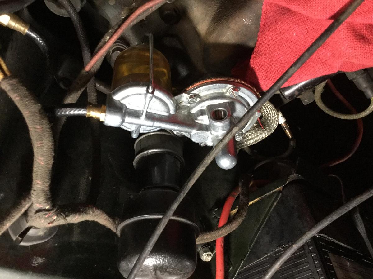

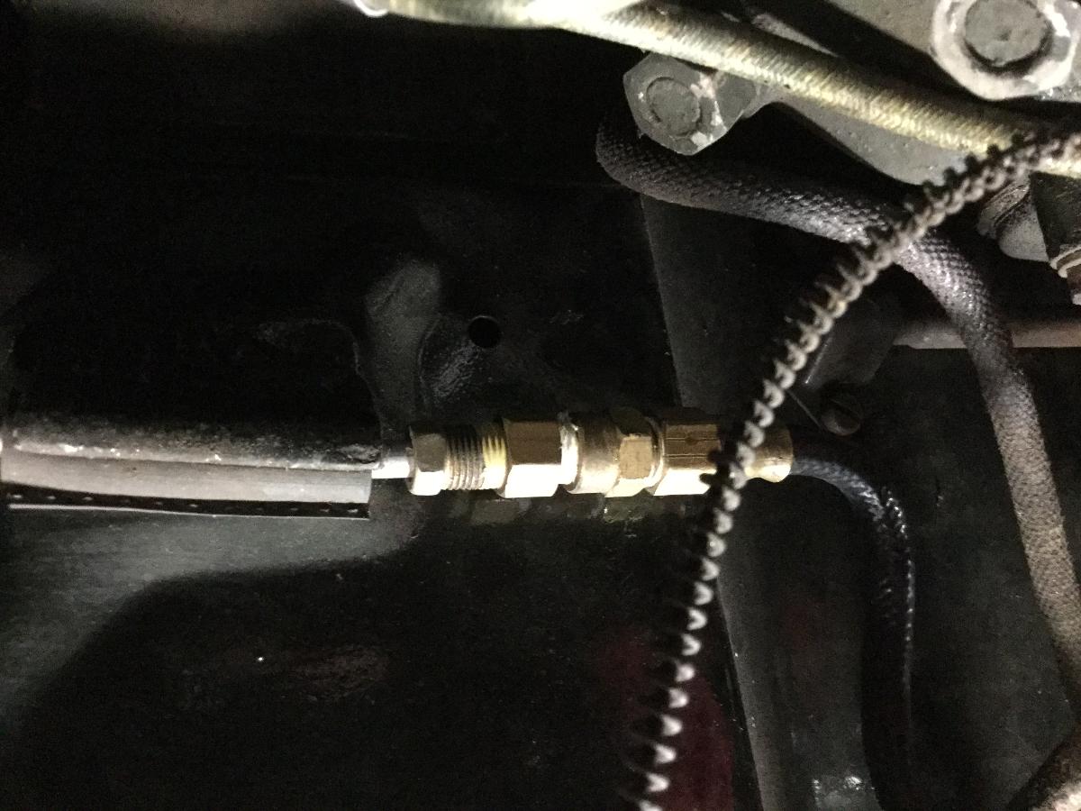

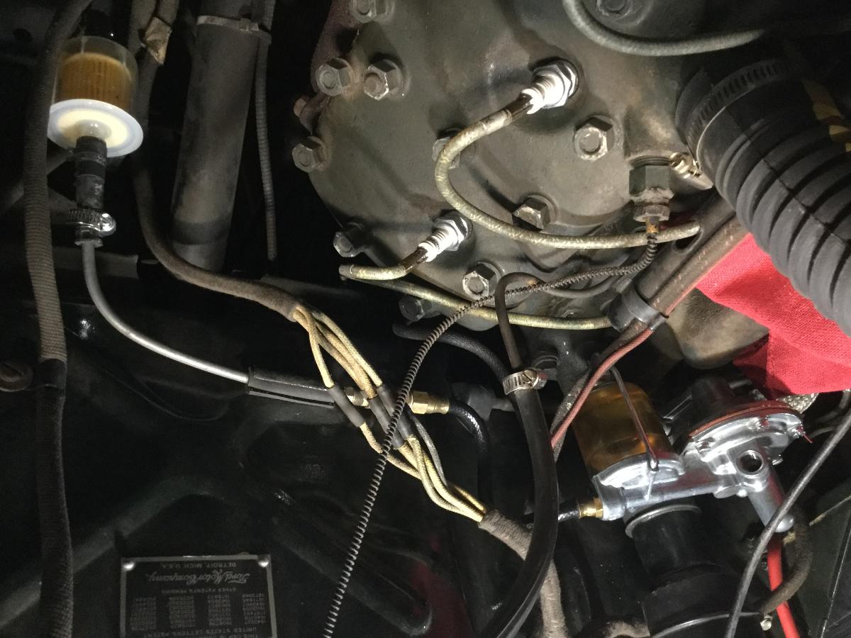

Thank you I will send you a picture today I’ve blown air through the line to the tank I will replace the rubber lines on the fire wall
Maple | -- 10-09-2020 @ 3:32 AM |
Here are several photos thank You
ken ct. | -- 10-09-2020 @ 4:10 AM |
FYI, Thats not the correct FP for a 39 but should work anyway. Replace the cork gasket on the glass bowl and i think you will be good to go, ken ct do NOT use a neoprene one..
TomO | -- 10-09-2020 @ 7:58 AM |
Did you fill the sediment bowl with gas? If you did not, the sediment bowl gasket is leaking. Try tightening the thumb screw at the base of the bolt. It should be hand tight. Throw away those spring hose clamps and use two new worm drive hose clamps. Push the hose all the way onto the filter until the hose seats against the shoulder on the filter. Install the worm drive clamps 1/8" from the end of the hose. If it were my car, I would throw the filter away and just use the sediment bowl and screen in the fuel pump. My car has been running that way for the past 18 years. Those filters cause more problems than they fix. Tom
