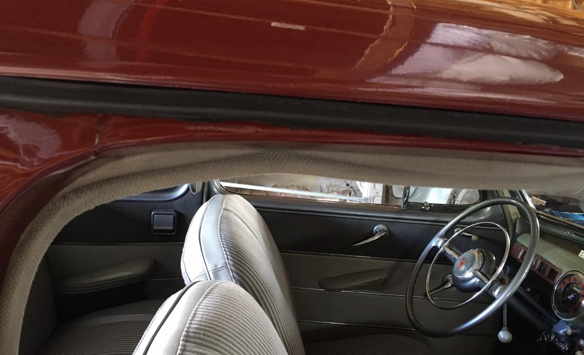

51woodie | -- 07-20-2020 @ 1:01 PM |
The windlace in a section above the passengers door has come loose, and I am looking for ideas on how to put it back up in place and secure it.

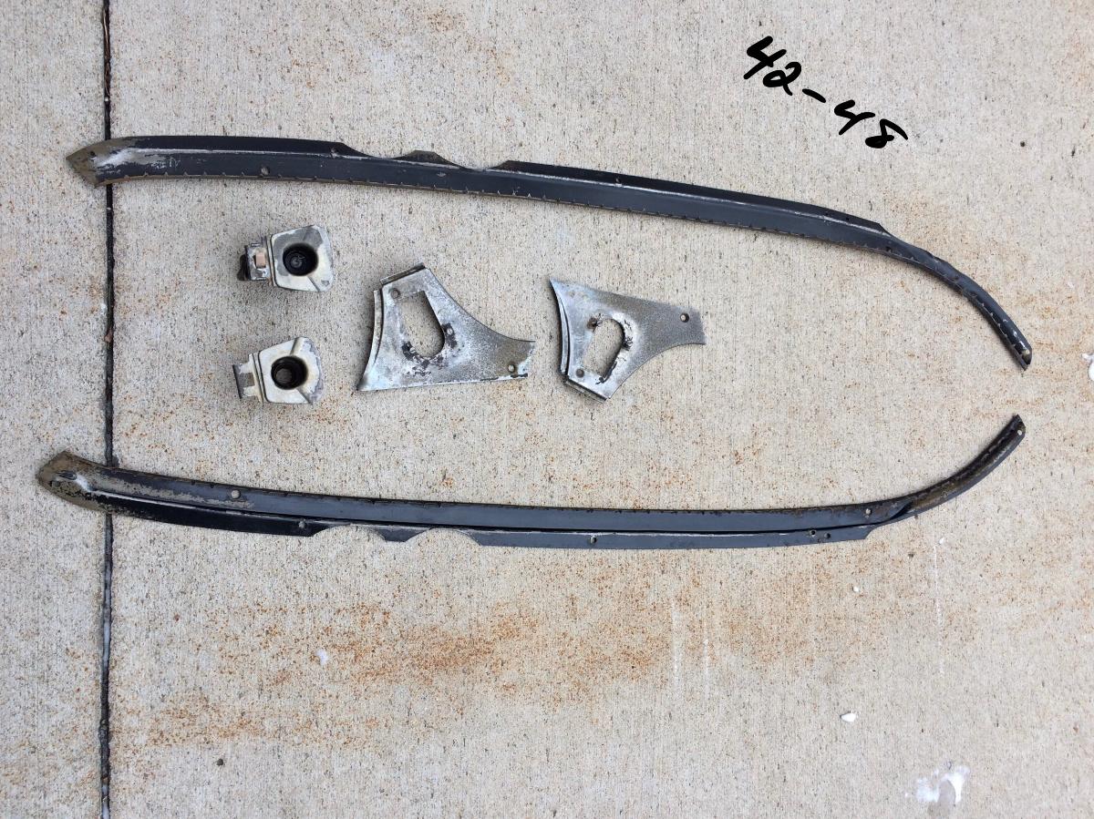

cpipp01@aol.com | -- 07-21-2020 @ 3:36 PM |
The metal pieces are headliner retainers and mount above the front door openings see photo.
