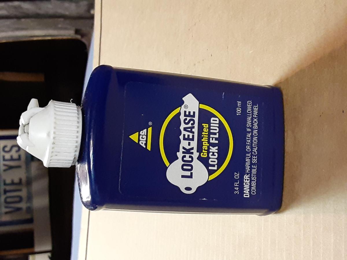

nelsb01 | -- 07-07-2020 @ 12:21 PM |
Yes---very gently. It should slide on, but with care. Here is a picture of what I have.

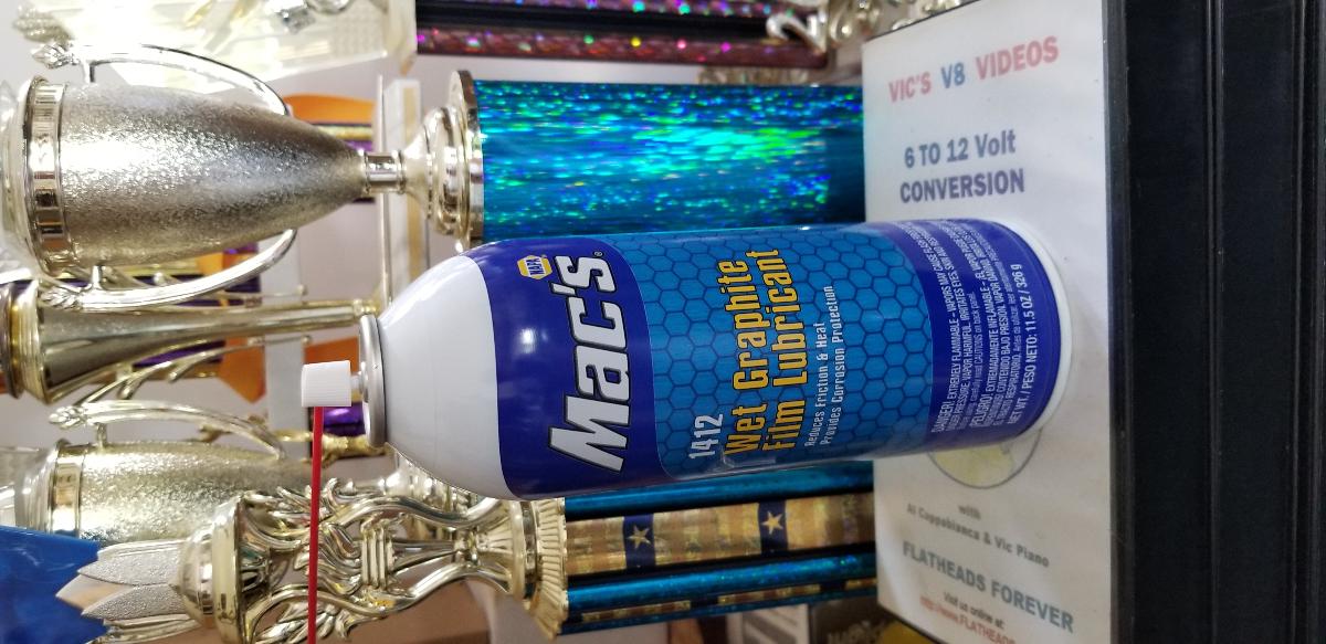

Dream38v8 | -- 07-20-2020 @ 1:55 PM |
I decided to work on the speedometer during one of the hottest days this summer. Got the speedometer out and disconnected the cable. The attached picture is the only liquid graphite I could locate. Thanks NAPA. After I spread the lubricant I let the cable set for 30 minutes. While waiting I reattached the needle. Once everything was back together I went for a test drive. The speedometer is working, but the needle is still bouncing. The bounce is probably 10% from the previous bounce before the needle fell off. At this time I am happy. Maybe this fall I will disconnect / remove the cable and clean and relub . Ray Ray
