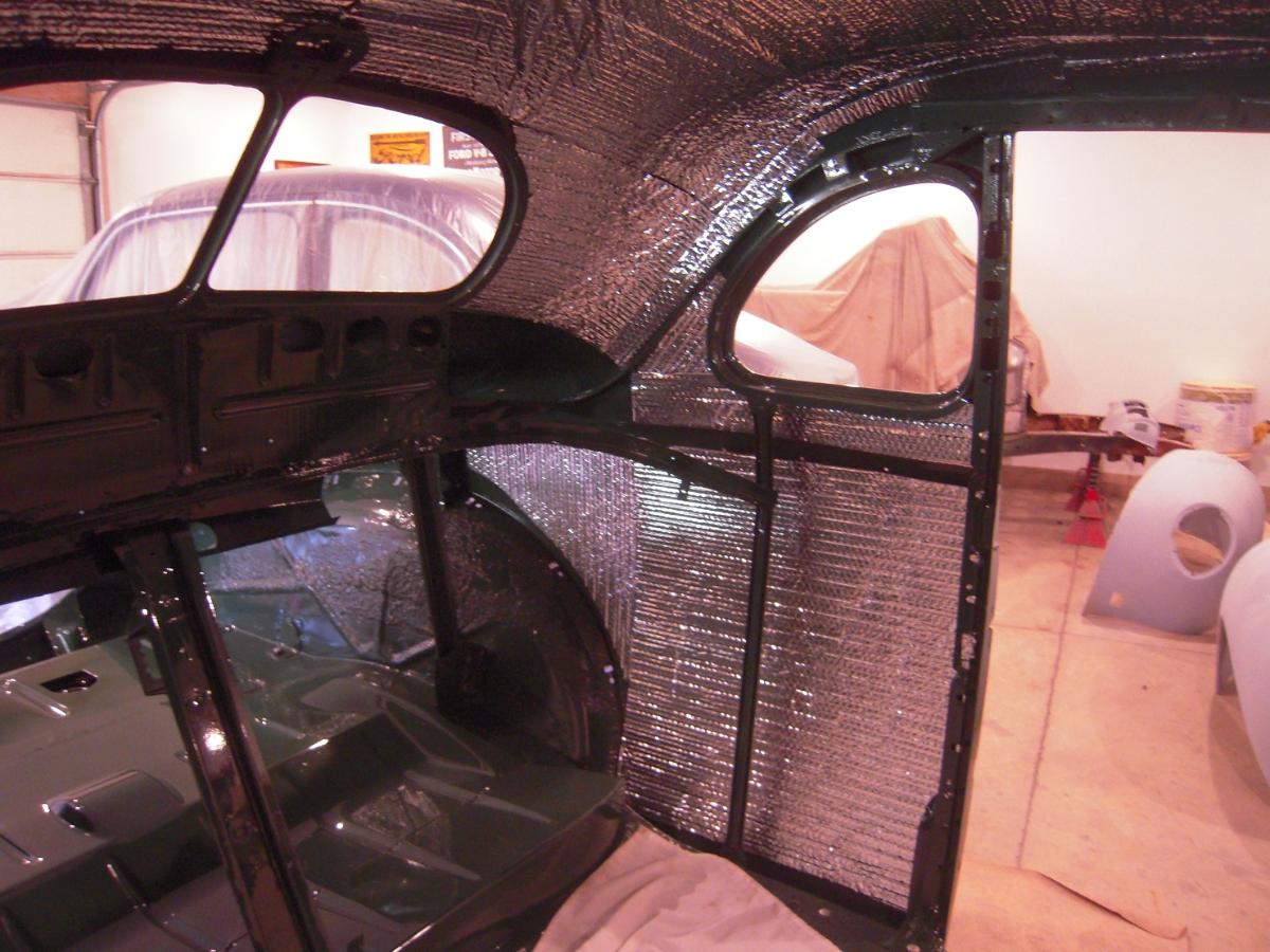

I use the bubble insulation from lowe's, work great, glue it into the doors, on walls, roof, anywhere you can attach it-even lay out under floor mats-will not hold moisture

Ya know, even in my "high end" restorations, I use the same thing Alan has suggested. I put it only in places that will never be seen again. Mike "Kube" Kubarth

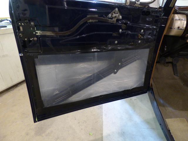

Thanks Mike ial look for some at lowes it might work better in the doors to with the limited roon to install the stuff with the peel and stick would be a nightmare
dandy32 | -- 07-02-2020 @ 4:28 PM |
what kind of adhesive do you use
alanwoodieman | -- 07-02-2020 @ 5:01 PM |
8090 3m spray contact adhesive, also have used the can-what a mess!!!
woodiewagon46 | -- 07-02-2020 @ 5:54 PM |
3M makes a product, 3M 08840, sound deadening pad's that are 19"x19", self adhesive, for about $75 for a 10 pack. A heck of a lot cheaper than Dynamat.
kubes40 | -- 07-02-2020 @ 6:28 PM |
I use the 3M contact cement in the can (sorry Alan)… I really trust the results to be long lasting. Mike "Kube" Kubarth
