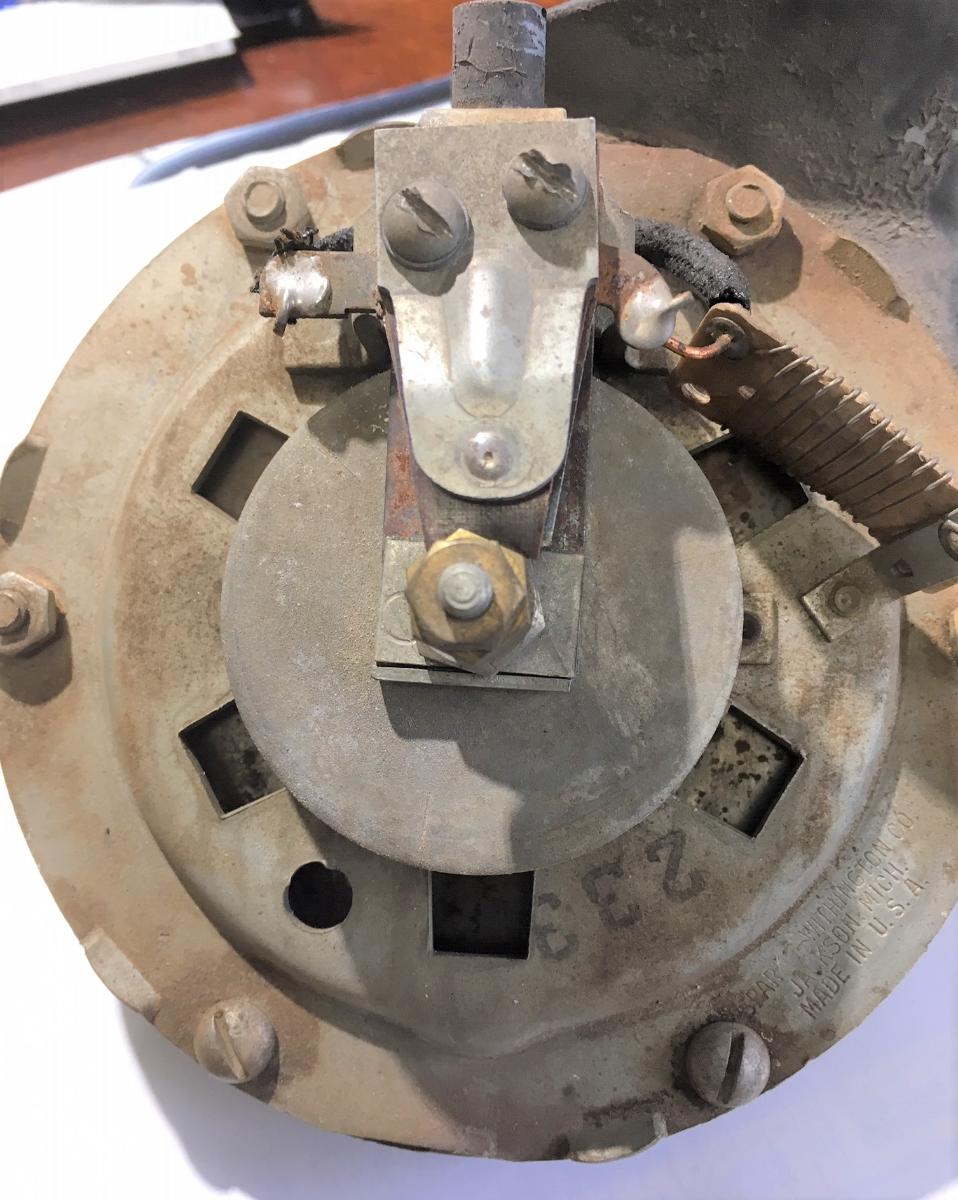

Anybody have a good horn repair guy?
51woodie | -- 06-29-2020 @ 1:33 PM |

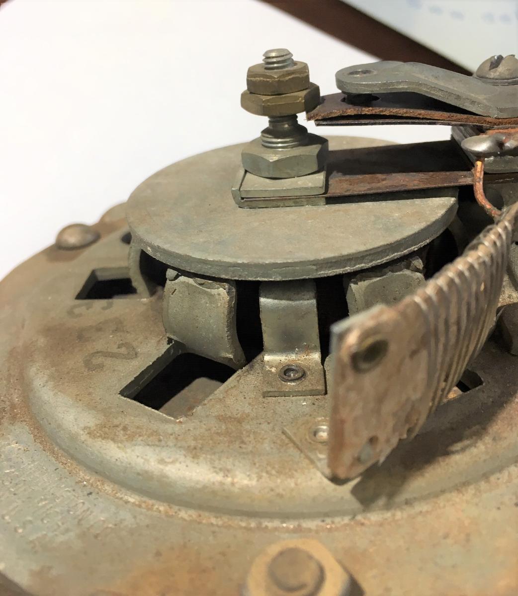

37fordguy. Have you considered checking it over yourself? I'm not familiar with the 37's horns, but the horns on my '46 were not working and I got them working. I removed the covers, checked the coils with an ohmmeter and they were good. I cleaned the contacts and voila, they worked.
