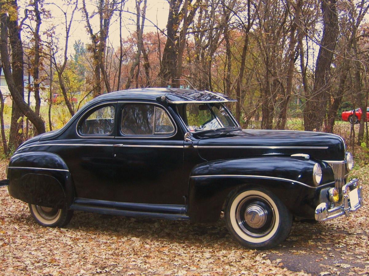

After purchasing a new set of tires for my car I found out two of the rims are bent. I am also in need a spare tire. The tires on my car are 16 inches. I am told they are not original to this model. Does anyone know if my car could have been fitted with 16 inch wheels from the factory and ,if not, where was the possible source of the wheels that are currently on this car?.

Looking at the pix of your car that you attached, shows that you have '41 style hub caps and the '41 style of 4 rib beauty rings. whom ever told you your wheels are not correct is clueless. Ford had a very good year in 1941, producing over 600,000 cars. The '41's were basically all new compared to the '40's. Bill 36 5 win delx cpe This message was edited by wmsteed on 6-19-20 @ 10:47 AM
