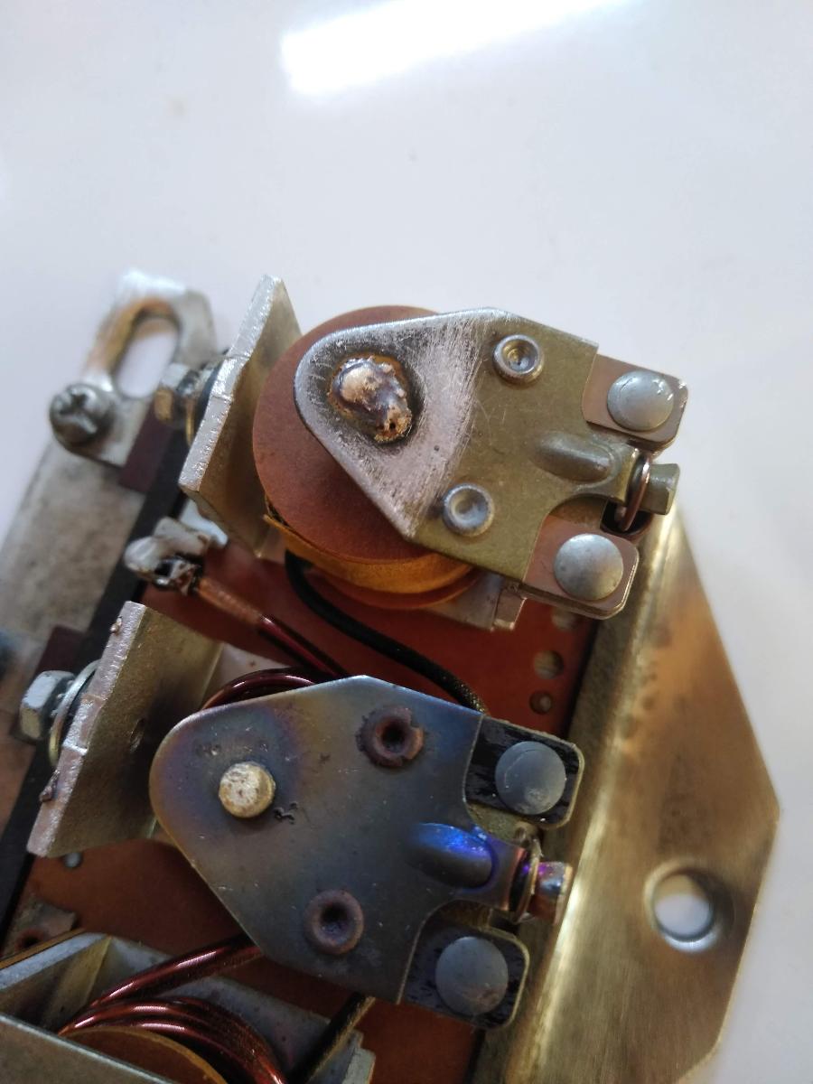

The generator on my 49 F-1 (6 volt system) is only putting out 2.96 volts at about 1100 rpm. Is this normal? I checked it at the generator with the wiring disconnected. I've been having charging problems. The ammeter NEVER indicates a charge. The voltage regulator has really burnt points and a blown fuse underneath. I don't know what happened and am planning on replacing both the generator and the regulator unless there's something I can do to fix the low output on the generator. Any ideas?

I know little about the generating system, so you should wait for others to post. But I can say that I think the test you did of the generator, with wires removed, is meaningless. The generator needs input from the regulator to function. From your description of the regulator, seems more likely you just need a new regulator.

I recommend an analog meter for this test (one with a needle), digital meters will vary with the spikes coming from the generator. To check if the problem is the generator or the regulator: Connect all of the wiring between the generator and regulator. Start the engine and let it run at about 1,000 rpm. Measure the voltage at the battery terminal of the voltage regulator, it should be at least 7 volts. If it is not 7 volts, leave the meter connected and connect a jumper from the ARM terminal of the regulator to the FLD terminal of the regulator, long enough to read the voltmeter. If it not now above 7 volts, the generator is bad, if it is above 7 volts the regulator is bad. Remove the jumper as soon as you get a reading, leaving it on for a long period will damage the generator. Tom
