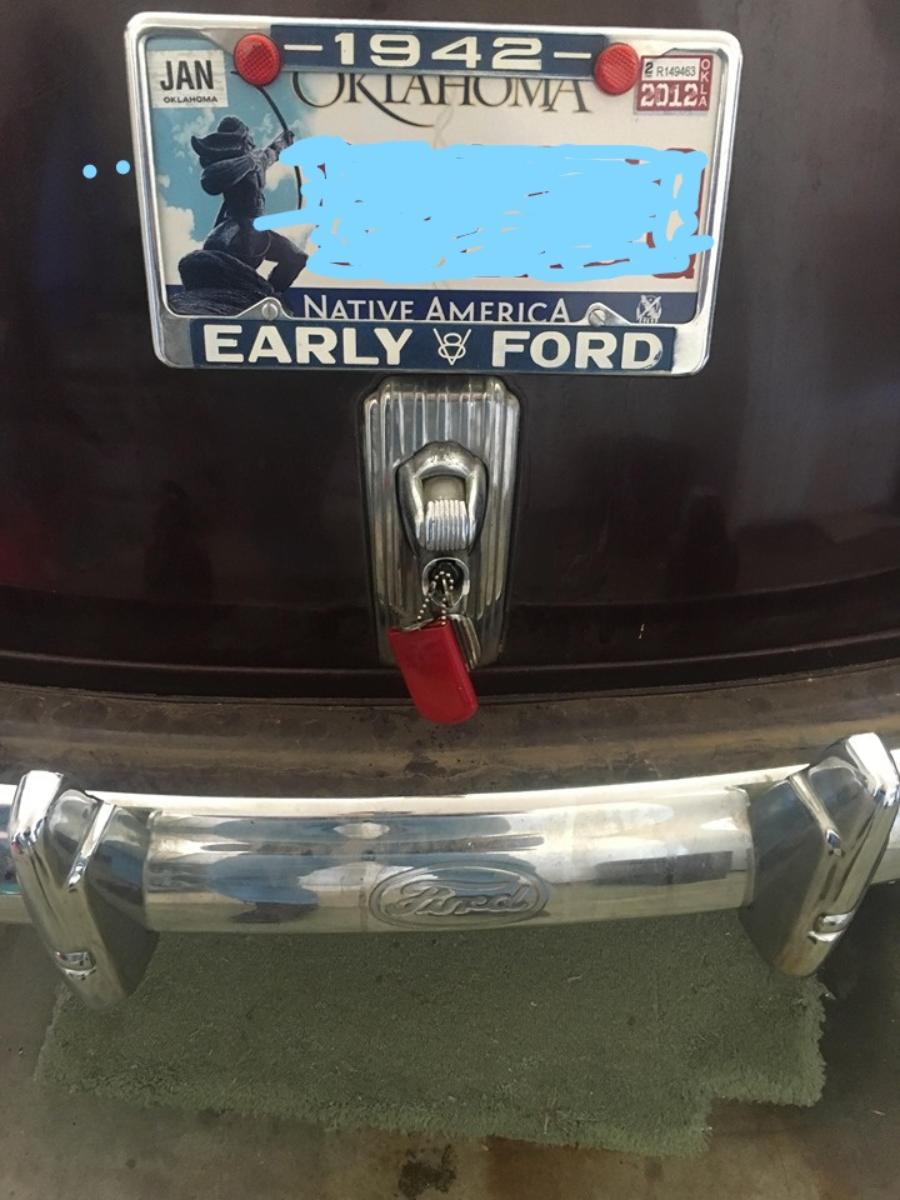

Hello......I am new to this as I just purchased a '42 Tudor Sedan and I have not owned a vintage vehicle quite this old before.....so hopefully you will bear with me on some of my inquiries......my first issue I am facing is after I got it home is that I cannot get the trunk unlocked.....I did get it open when I went to pick it up (with a little jiggling of the key).....but it appears it doesn't want to work any longer.......I have cleaned and lubed the lock very well and have spent a fair amount of time messing with it, but it just won't unlock.....I have called a few mobile locksmiths but have yet to come up with one willing to give it a shot (seems strange, huh).....I still have some to call but not holding my breath. Anyway, I am curious if anyone else has had this issue and maybe can help me out with a possible solution.....like can you access the trunk by removing the rear seat ? Or drill out the lock ?? (I am going to replace the complete assembly once I can get it open to remove it so I don't care if it gets ruined that way) Any suggestions would be greatly appreciated. Thanks !

It is possible that the key is too worn to operate the lock properly. Originally the glove box and trunk were keyed alike. You can take the lock cylinder out of the dash pocket and get the number off it. Maybe a local locksmith can cut a new key by the number. If not, there are some that specialize in old Ford locks that can cut one.

That is a very nice looking car. You cannot access the trunk lock by removing the back seat. The spare tire and bracing are in the way. Have you tried both keys? WD40 will sometimes free up the tumblers so that the key will work, other than that, jiggling the key while working the handle back and forth may free up the lock. One you have the trunk open, take the handle to a locksmith to have the lock repaired or removed so a new lock can be installed. Tom

Tom....he worked on it for the better part of an hour but could not get the tumblers to drop....ended up he had to drill the cylinder out....would have preferred not to do that but thats what it came down to. At least I can get i to the trunk now (even if it doesn’t lock). I will just replace the complete assy with new.

42 flattman, Now that you've gotten it open, I would suggest that you contact either one or both of the contacts I listed above to get an idea as to what you can do to replace the lock. They will probably have NOS lock tumblers/parts and will give you guidance on how to get the lock to function. Also, you could send the entire mechanism to one of them to get a proper repair if you are not comfortable to do t. There are "new" reproduction parts available be they are "poopy" and don't seem to operate the same as original. Ken

You can add my support to Ken's opinion on getting a NOS lock. The reproductions that I have seen are very poorly made and likely to fail in a few years. Call one of the contact that Ken supplied and see if they will rekey your glove box lock at the same time that they fix your handle. Or you can have a local locksmith rekey the glove box lock to match the new trunk lock. Tom
