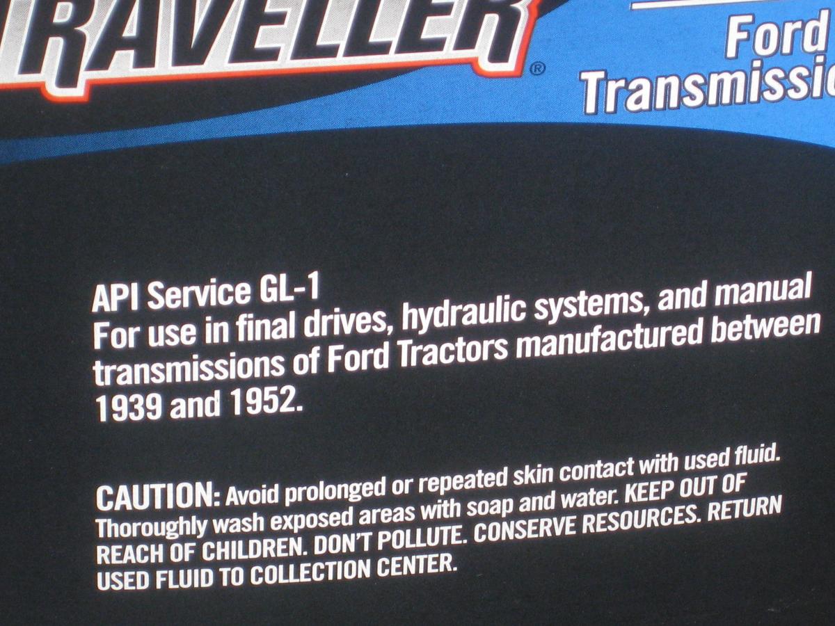

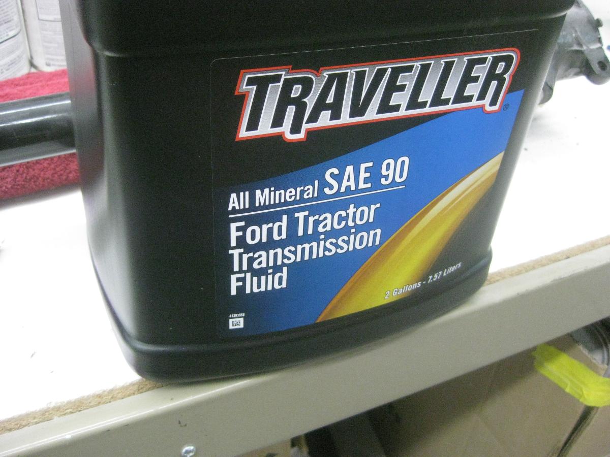

90W, but not any modern one!!; it has things in it that will harm the brass bushing etc.. Fifth Ave Garage has the right one. They are in Clay Center in Kansa City, Kansas. Google them for phone number! The Ford parts dealer in s. carolina has it too! Regards, Steve Lee
nelsb01 | -- 05-12-2020 @ 7:46 PM |
Or............... If you have a Tractor Supply store in your state, stop and see them. They carry a large assortment of old oils and gear lubs. This message was edited by nelsb01 on 5-12-20 @ 7:50 PM
carcrazy | -- 05-12-2020 @ 9:58 PM |
You can also buy SAE 90W API GL-1 Mineral Gear Oil at your friendly NAPA store. It is available in 1 gallon containers under part no. 65-201. If they don't have any in stock, they can order it for you and have it in a day or so.
