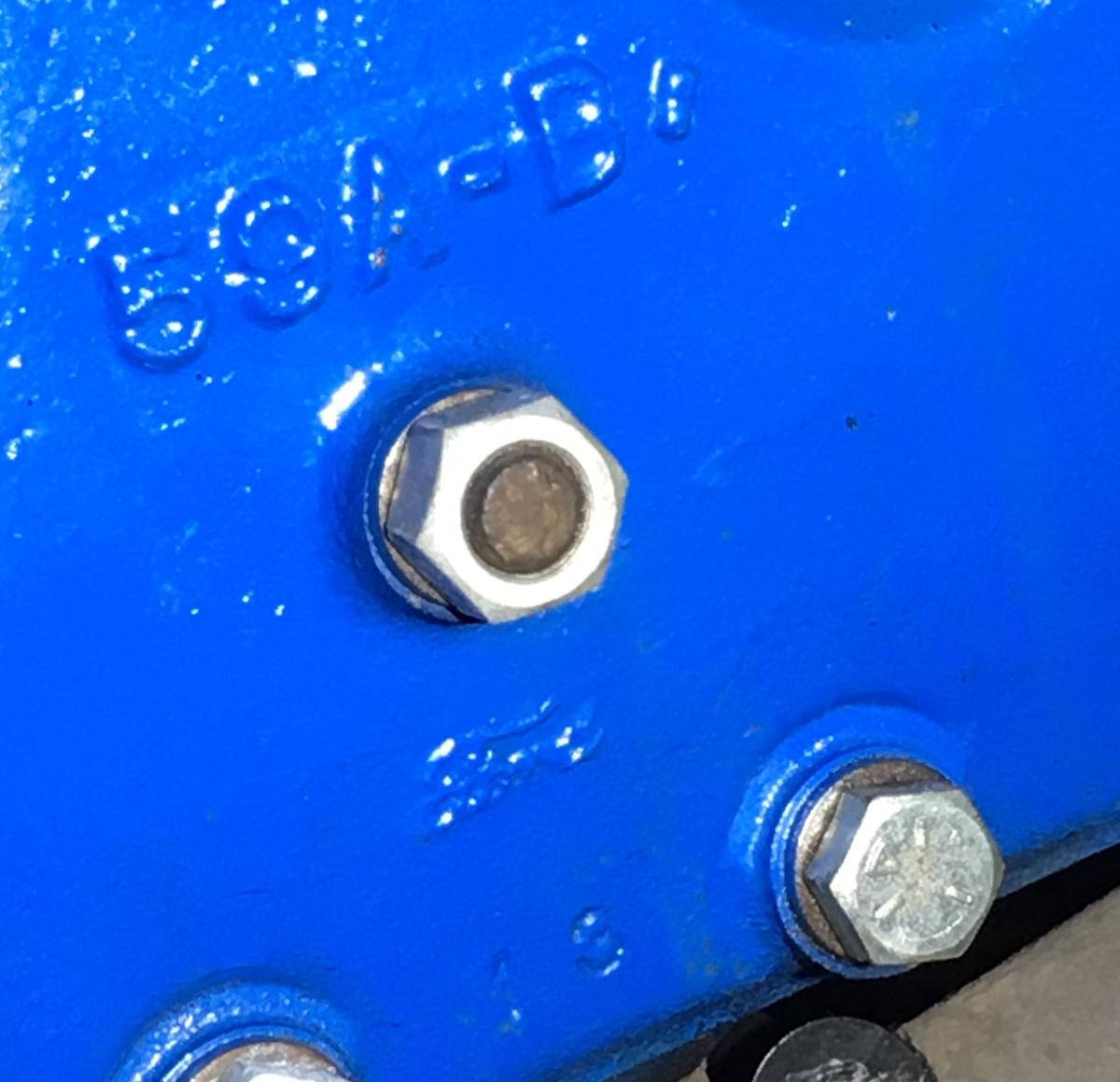

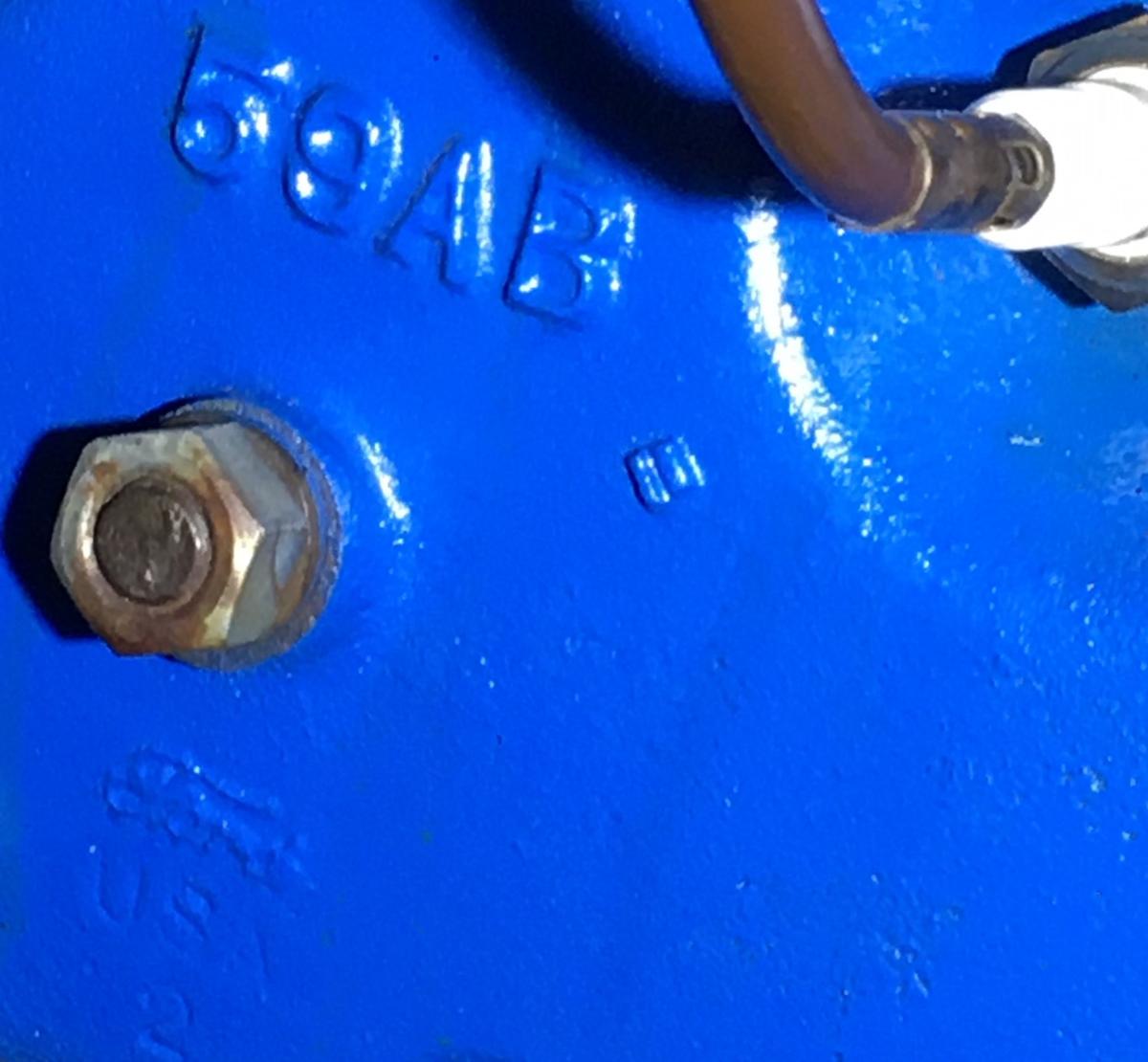

I noticed that the cylinder heads on the 59AB in my '46 Coupe have different numbers on them. Some cast in and some look like they were stamped in. Is this normal during production, or has one of the heads been replaced? This was originally a California car, and I believe I am the sixth owner. This is just a question out of curiosity. The left (driver's side) has 59A-B cast in, and the number 13 stamped below the Ford logo. The right (pass side) has 59AB cast in, and USA stamped below the Ford logo. 2
kubes40 | -- 05-12-2020 @ 3:54 PM |
The "AB" vs "A-B" is simply a casting difference. The dimensions of the heads are identical. The "13" and "2" are no more than the cast (core) number. Mike "Kube" Kubarth
