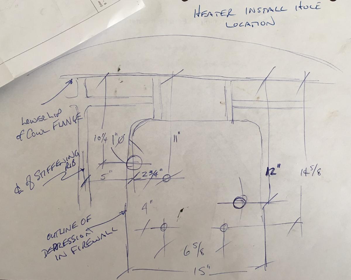

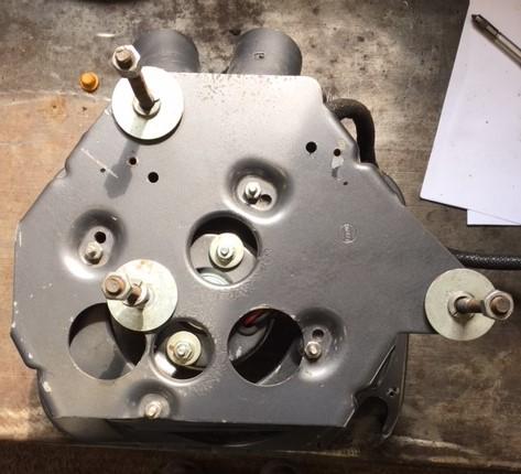

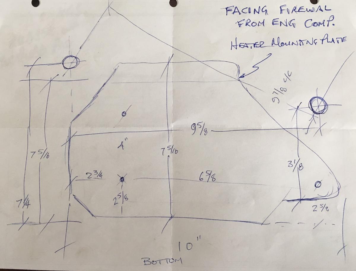

51woodie | -- 05-09-2020 @ 4:16 PM |
coupeman The heater in my '46 is the same as shown on page A-3, fig. a-2 of the 41-48 book. Mine is gray metallic as shown in the book. I'm not sure what info you are looking for, so I attached what may be helpful to you.
