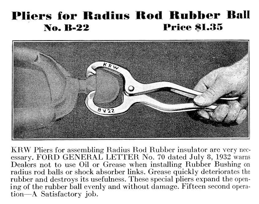

3w2 | -- 04-30-2020 @ 11:29 AM |
I use rattle can silicone on the inside of the ball plus the special K.R. Wilson pliers (Bv-22) made for the task.
