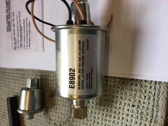

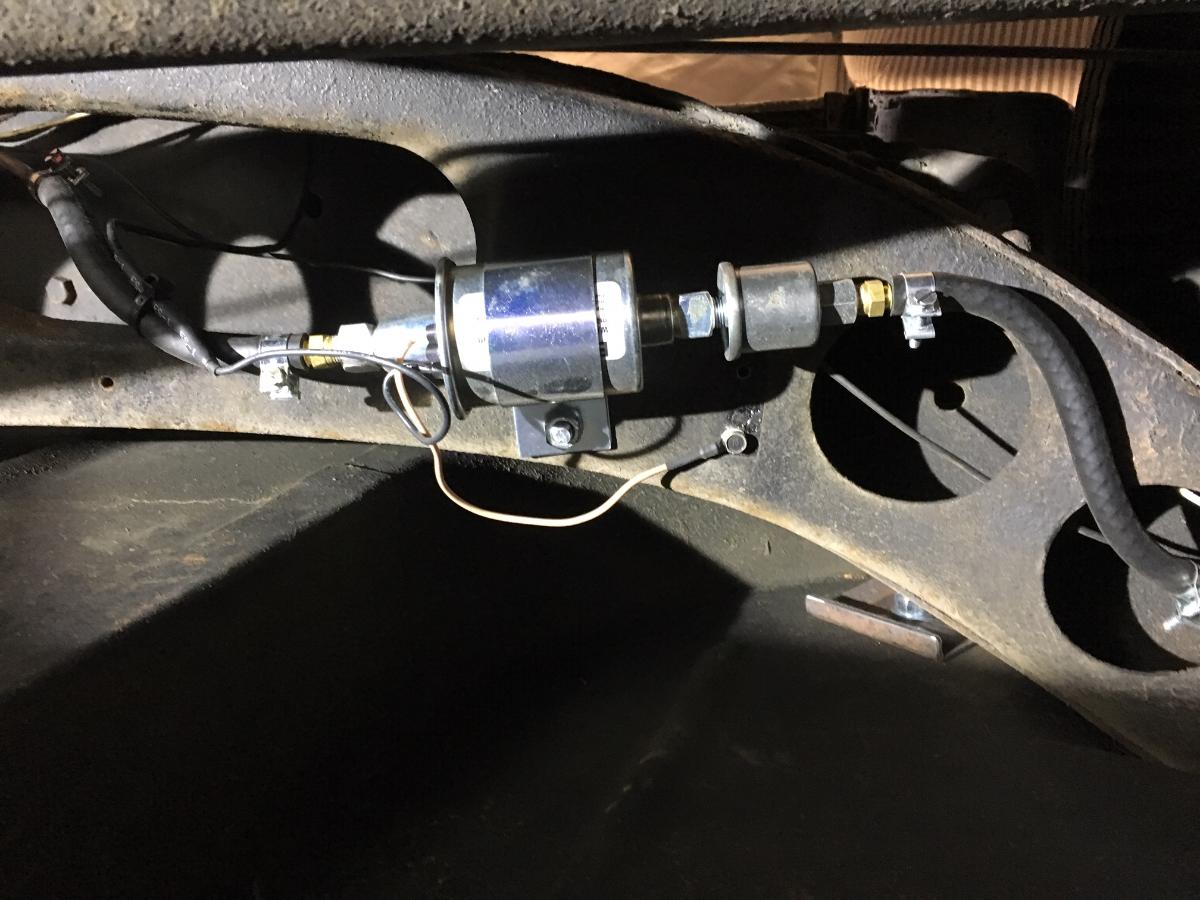

51woodie | -- 03-19-2020 @ 10:21 AM |
I installed a 6 volt Airtex E8902 on my '46 coupe in 2018, which I bought from Rockauto for $32.00. I only use it for "priming' after the car has sat for a number of days. It works well for me, has the right pressure, and is a "flow through" design, which allows the engine fuel pump to provide flow to the carb when the engine is running. I also used the metal fuel filter with threaded connection to the inlet of the pump.
