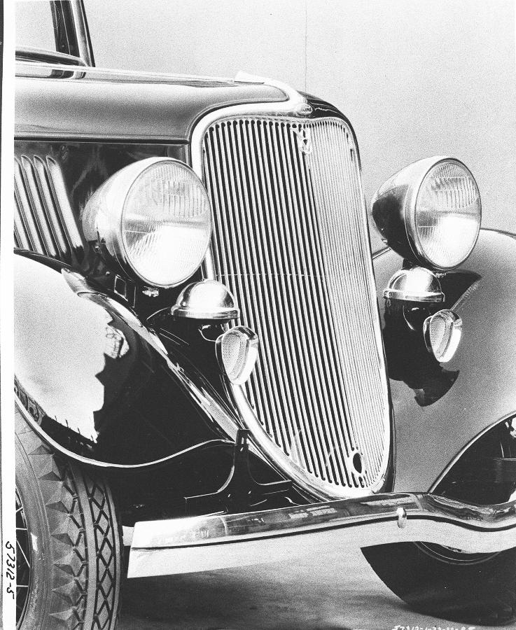

Since the horn wires pass through the hollow bolts that attach the horn brackets, logic prevails and the wires should exit the covers closest to the opening in the bolt heads., which is away from the hood. The orientation of the horn center section makes no difference regarding the horns' operation, but again should be assembled with the distance between the wire connections and the exit notch in the cover minimized. The attached Ford archives photo of a '33 front end may be helpful. This message was edited by 3w2 on 1-10-20 @ 5:49 PM

Please note the corrected text in my note and the addition of a photo. Sorry for the confusion.
